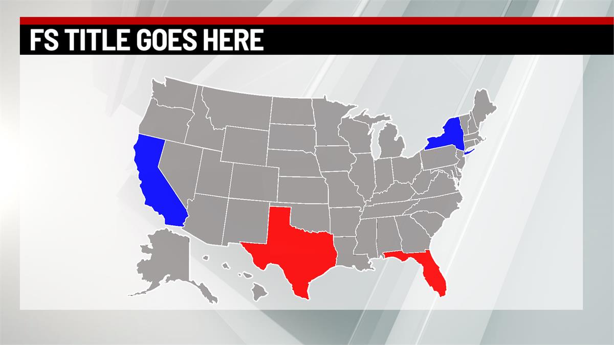

    I created a scene that uses scripting to take a comma-separated list of us states and then fills in the outlines of those states with a solid color. The state outlines are in a 3d model and I used the "Set Material" method to assign from a list of materials that are in the project.

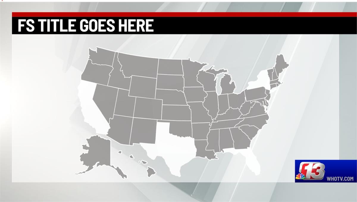

    This works fine in the Xpression Designer, but not in Xpression Studio​ (or the Xpression MOS Plugin inside ENPS). On either of those platforms, the outlines just disappear (as if their opacity has been set to 0%).
    Example: Xpression Designer:
    US MAP showing Texas and Florida highlighted in red, while California and New York are highlighted in Blueand in Xpression Studio:
    US Map with Texas, Florida, California and New York missing

    In your script, you're calling on the materials using the Engine.GetMaterialByName method:
    Engine.GetMaterialByName("mapRed",redMat)
    Engine.GetMaterialByName("mapBlue",blueMat)
    Engine.GetMaterialByName("mapGreen",greenMat)
    Engine.GetMaterialByName("mapYellow",yellMat)
    Engine.GetMaterialByName("mapOrange",orangeMat)
    Engine.GetMaterialByName("mapPurple",purpleMat)
    But when a scene is played out through the MOS workflow, either on the BlueBox OFL for Plugin previews, or on the Studio Engine for output, the project never becomes active in the engine, so the Materials aren't available that way. Try changing your OnOnline and OnPreviewRender scripts to get the materials using the Self.Project.GetMaterialByName method. This should allow the script to retrieve those materials from the Project for preview and playout.
