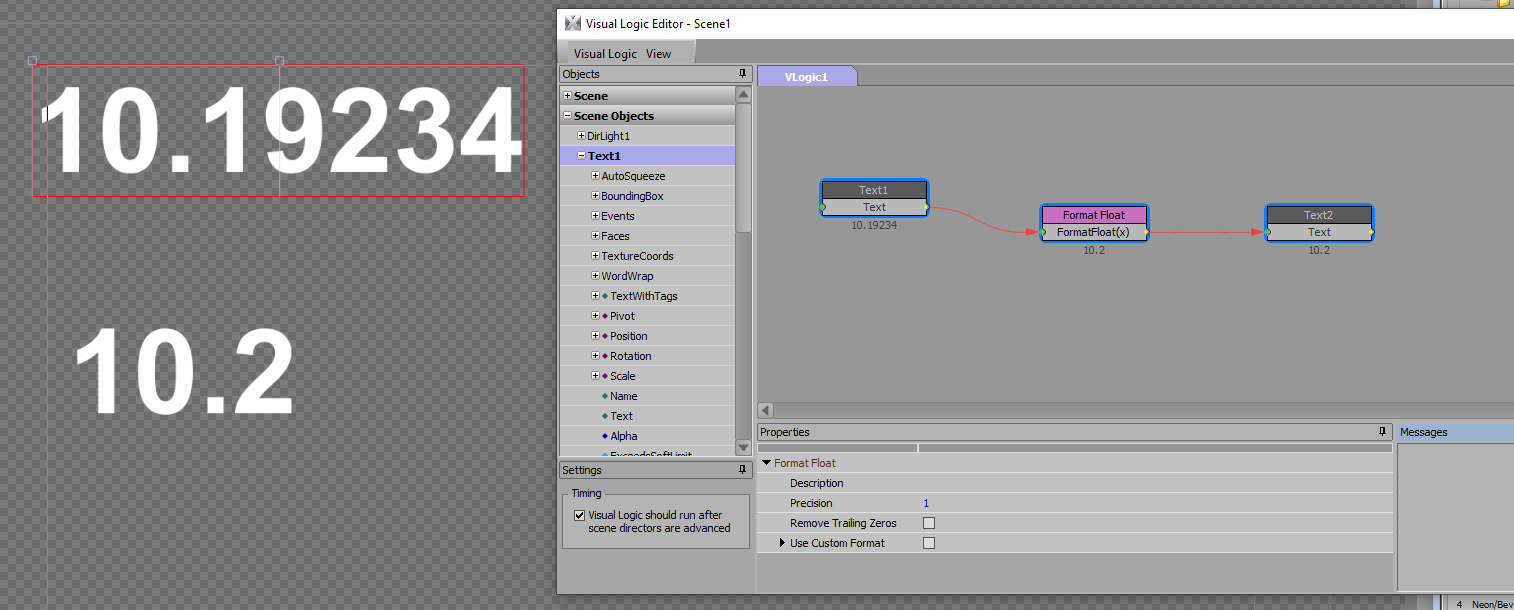

  • 4.  RE: Rounding off number in visual logic
    Best Answer
    Posted 12-03-2021 05:58
    Does this do what you want?
    Change the precision to "1"
    Test Pilot | Senior Graphic Programmer & Designer
    London United Kingdom
  • 5.  RE: Rounding off number in visual logic
    Posted 12-03-2021 08:25
    Yes! Brilliant, thank you!
