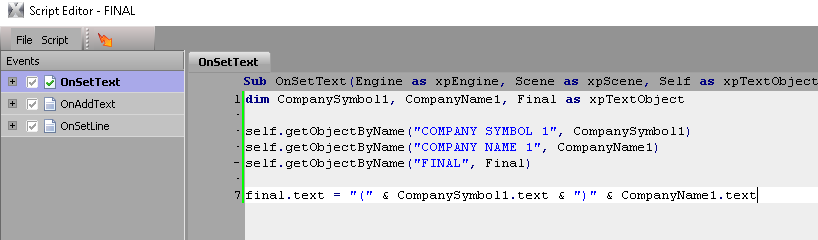

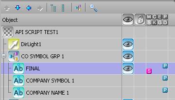

    Thank you for the time & effort put into this.  Unfortunately, I can't seem to make this work.  I'm sure it's something I'm doing wrong.  Along your theory with the hidden data, I remade my text fields into Company Symbol (hidden text), Company Name (hidden text), then Final (where I believe the hidden text is supposed to show.
    Here is my Object Manager:
    And here is the script:
    What did I do wrong?
    Mark Stasiowski
  • 10.  RE: Previewing a script and visual logic on the same text line
    Posted 08-12-2021 01:25
    Looking at your project, the script should go at the very top element. "API SCRIPT TEST1". I gave you the wrong information on one of my previous posts.

  • 11.  RE: Previewing a script and visual logic on the same text line
    Posted 08-12-2021 01:41
    MalThePal -
    It works!  Thank you again!  Scripting is definitely a nice option to have sometimes instead of Visual Logic, I just have to learn more about it.

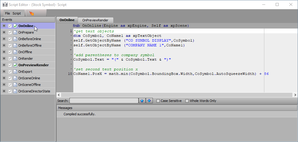

    That being said, you can do this all in a script, although I had to place it on the Scene object (in both the OnOnline and OnPreviewRender events,) not the Text Object, in order to move the X Position of the Company Name text object.
    The script for spacing would just be CoName.PosX = CoSymbol.BoundingBox.Width to which you can add your offset. Also, since your visual logic was using the BoundingBox.WidthScaled, you can use the Math.Min function to account for any Auto Squeeze you have set on your Symbol Text object.

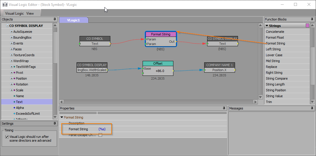

    A quick note if you try to go the Visual Logic route...you can also use the FormatString block (added in v 6.7), which in this case might be a bit cleaner than using Concatenate.

    Posted 08-09-2021 13:29
    Mark-
    Did the script compile correctly (you get the green check mark when you click the Fire icon) when you added it to the OnOnline and OnPreviewRender events? I based the Text Object names off your visual logic screen capture, so if not, you might want to double check those names.
    When you tried switching back visual logic again, any chance you unchecked the Enable button on your visual logic tab when working with the script? That catches me from time to time going back and forth.

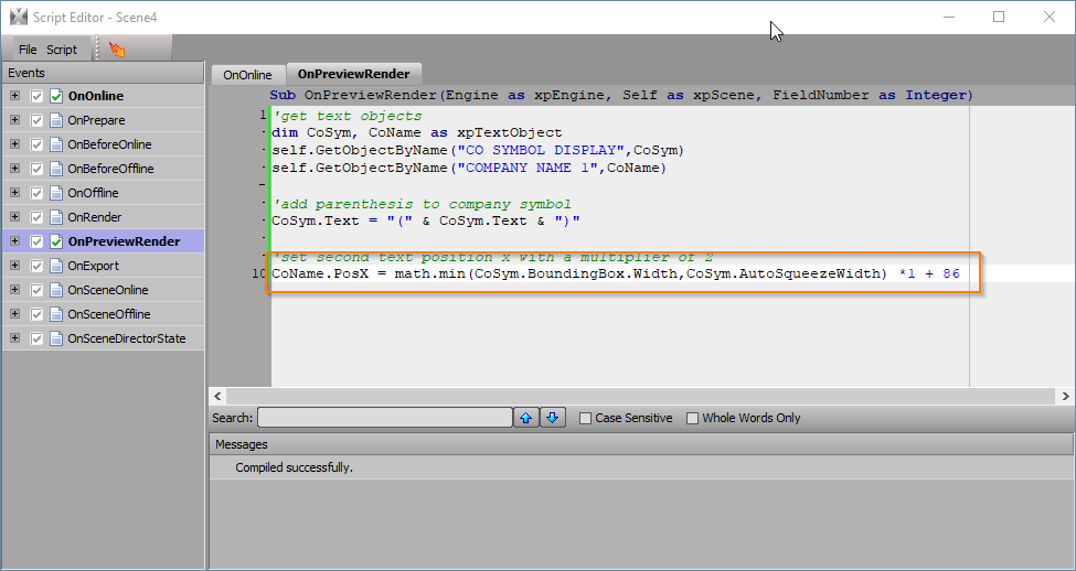

    Posted 08-12-2021 01:23
    Jeff -
    I got this to work but I'm hung up on the spacing part.  It looks like I have to have a multiplier along with my offset.  How can I have both to adjust the spacing and x position of the company name?
    Thank you again for your help.
    Mark Stasiowski
  • 17.  RE: Previewing a script and visual logic on the same text line
    Posted 08-12-2021 02:44
    Mark -
    You can add * 1 to the script to act as your multiplier that matches your visual logic, but like Simon mentioned above, multiplying by 1 gives you the same number, so it's really not necessary (sometimes we'll multiply by -1 if we're working to move the Y Position down the scene, but in this case, moving your X Position to the right you don't need to.)
    Also Remember your Order of Operation from math anytime you do need to use more than one operator. Division is calculated before addition, so down the road if you need to add two values, then multiply that result, you'd need to use parenthesis to script that (a +b) * c.
