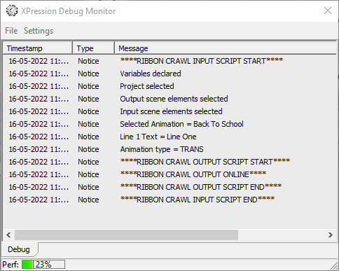

    We recently upgraded our XPression system to 10.5 build 5518, and we're running into an issue where a script has stopped working on one engine but runs perfectly fine on another.  The script runs OnOnline and recalls another scene to to a different layer on the same framebuffer then sets text and clips based on selected options in the parent template.  On the affected engine the script gets to a specific point then stops.  Below is a screenshot of the script debug monitor when the script runs successfully:

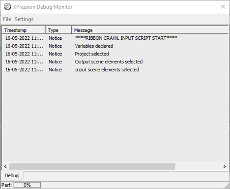

    And the one below from the engine that it fails on:
    We've tried reinstalling Studio, making sure the script engine was installed, and it has not resolved the issue.  Ross tech support has a copy of the project and the script is working for them.  Has anyone come across a similar issue?  Script in question is below.  Thanks in advance!

    my guess is for some reason txtAnimation is null; you could try wrapping the script in a try catch and see if any errors are thrown; I also recommend trying to delete the on disk script cache and restart XPression

    Thank you for the reply, Brandon.  It looks like it was a cache issue.  Props to Flint Gleeson and team for finding the cache setting was looking to an old BlueBox path.  This box was converted to Studio in 2019.  Setting the correct path effectively cleared the cache and the script started working again.  Thanks again!
