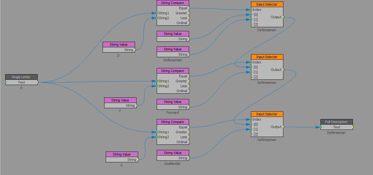

    Hey Tristan,
    As always, there are multiple way to do this, but give this a shot.

    Steve,
    Unfortunately that did not work. I was getting a "0" when I tried to input the Data into Xpressions.
    I was able to figure it out with the REPLACE module. But the way I did it is ass-backwards, it worked for me.

  • 5.  RE: Changing a single letter to full word in Visual Logic via DataLinq
    Posted 10-08-2020 19:45
    Cool! Glad you got it to work. Many options. For anyone who comes across this in the future:
    Tested that above example again, and the only way that you can get a 0 value at the second text input is if the Output of your first Input Selector is plugged into the Index of your Second Input Selector. Your First Input Selector Output should go into the "0" of the second input Selector. That first Input Selector can only output blank or Defenseman based on the argument "0" = nothing and "1" = defenseman. I would double check where you pointed the different outputs.

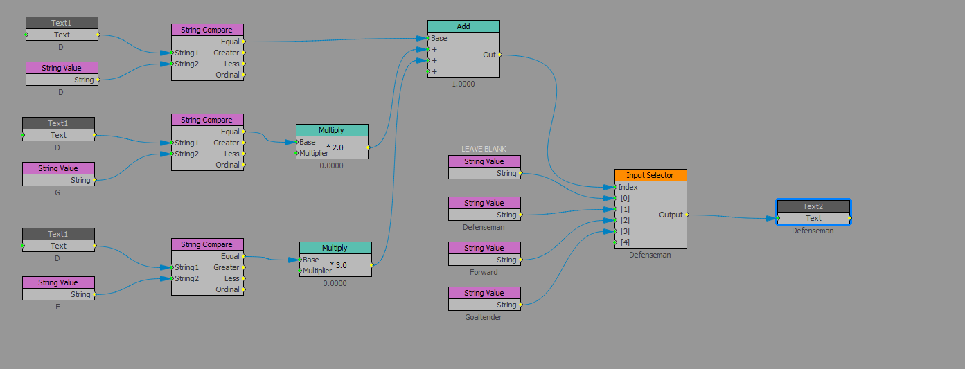

    Another way to accomplish this is using one Input Selector block and using Math blocks to increase the boolean value to the appropriate numbers. You could also skip that "blank" String Value block going into "0" and increment the Input Selector to start at "1"
