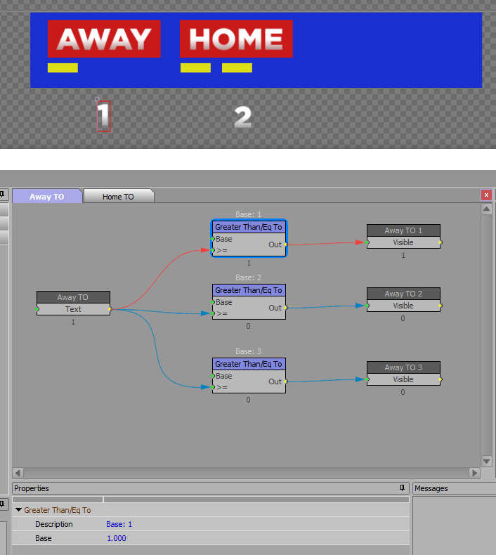

    I am trying to take this Scorebug "attached" and have the timeouts disappear using Datalinq.
    I already made each Chicklet "yellow square" its own material and know there has to be a way with Visual Logic
    I just cannot seem to get the result I am looking for.
    Example: If the SHARKS have 2 timeouts remaining, the value from Daktronics Datalinq will be "2" and I would want to have the 3rd chicklet disappear.
    Thanks again in advance

    I cant say how it's done by script, but if you want to do this by Visual logic. What you can do is use an input selector block, fred the index input the dactronics data, feed it four string values (000, 100, 110, 111), then use the output you get from the input selector, use the mid string block to grab the individual values from the resulting string, and then use them to toggle the visibility of each Chicklet

    Here's another way to come at the Visual Logic using fewer blocks. Evaluate your Timeout text object field to see if its value is Greater Than or Equal to 3, 2 and 1. Then use the result of those logic blocks to control the visibility of your 3rd, 2nd and 1st Timeout "chicklet" objects.

    Follow up question, what type of value does a <= block expect? The reason I did what I explained above is I ran into problems with that block not reacting as expected with different values inserted.

    It will accept boolean, Integer, float or string (assuming the string is a number).
