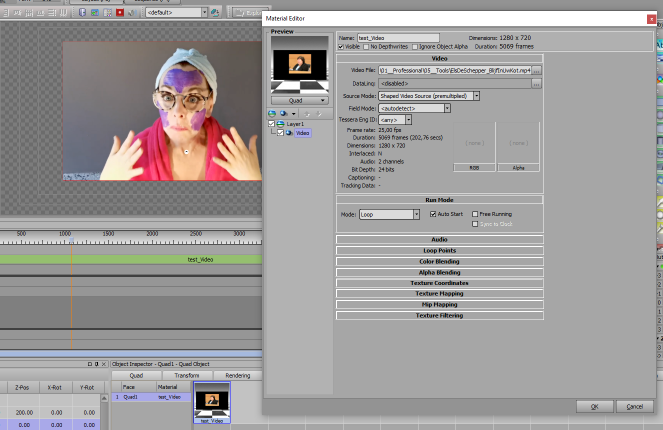

    The first option is the easiest to answer. In your XPression-project you need to add the video to the position you need, and in the material settings, you need to set the video to Loop and check the Auto Start.
