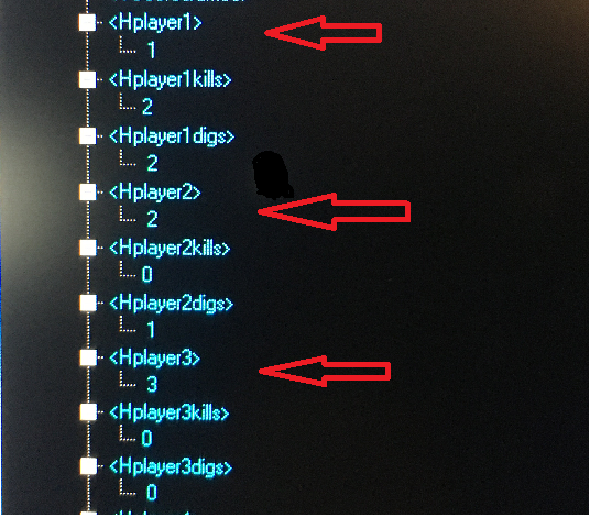

    Hi there,
    I am attempting to pull data from a Scorebot Volleyball & Basketball (See Volleyball picture below) from the HPlayer 1, 2, 3, etc and the VPlayer 1, 2, 3 (Not Shown) these get the player number of the players that are on the court.  What I am trying to do is pull their Player Name, Year of Eligibility, Hometown, & Jersey number from a separate excel sheet, which is working fine.  The problem I am having is because they use the HPlayer 1, 2, 3 for any player that is on the floor how do I get the datalinq to translate HPlayer 1 and then find the correct Jersey Num to fill the Player Side bar that I am wanting to put on the screen with "No Official Game Data".

    An example of the data I am receiving from Scorebot Volleyball.

    Column: Game\Event<type_id=16>\Q<qualifier_id=103>
    Row: value
    So that would return data only where that Event Type existed and then the qualifier existed.  It was a way of searching through data in a weird way without it being tabled.
    So in your case I would think you could do something with the data to grab the jersey number next to the arrows you have drawn.  That data will go back to Xpression into a text box.  That text box would then be used as a text macro and a datalinq key in order to sort through an excel sheet of data that you manually type out to display what you want to display.  So not visual logic, it is all a script.  And you will need the script for getting a datalinq key by name and resetting that data.

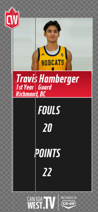

    Thanks for your reply.  I am sorry for the lack of pictures the other day I wasn't at the XPression.  Here are some pictures to help makes sense of my question.
    This is what it's supposed to look like.
    Player Side Bar

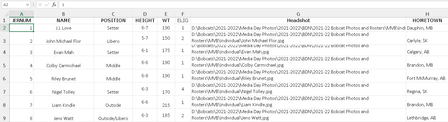

    Here is the excel data.
    Excel Data Example

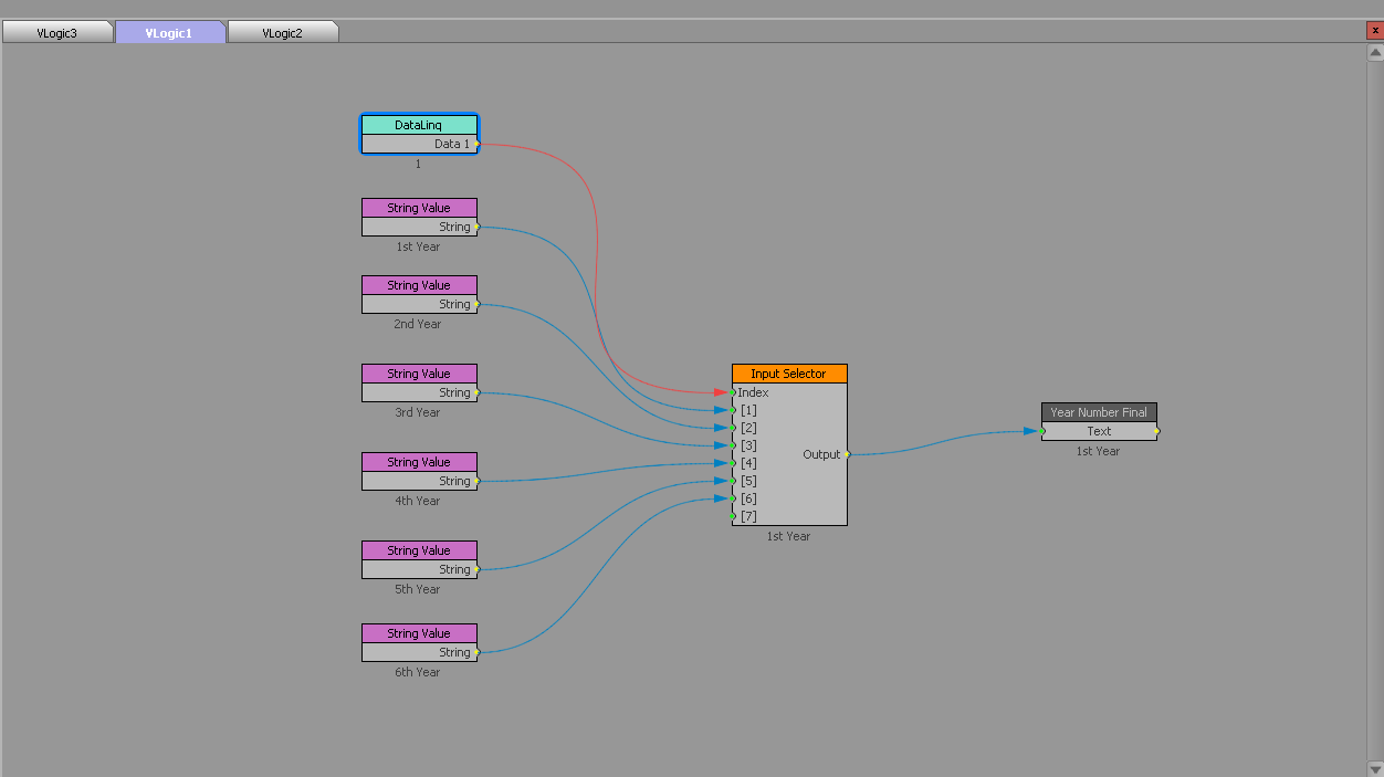

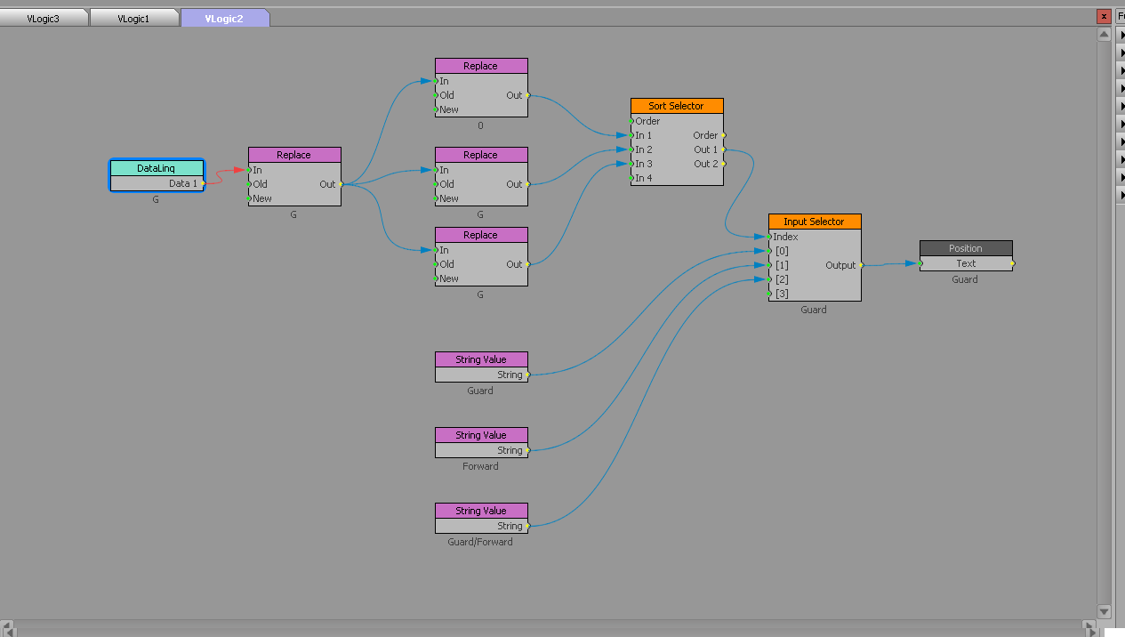

    Here is the Visual Logic for the Year and Position.
    Visual Logic Position
    Visual Logic coding for the Year.

    The visual logic for the 1st year-6th year, that can be a simple script as well.
    dim TEXT as xpTextObject
    scene.getObjectbyName ("Name of the Text Field", TEXT)
    if text = "1" then
    Text.text = "1st Year"
    else if text = "2" then
    Text.Text = "2nd Year"
    etc etc.  Sorry if there is a typo in that on the scene parts as I am not typing this from Xpression.

    So then if the data in the excel sheet is tabled.  You can do an SQL Query of that data (see Xpression U videos).  Then use the jersey number inside of that.  It should only return one line of data since there should only be one person with that jersey number (sorry American football people, not you).  Then now you have that line in excel and use that data anywhere.  Name, number, position, year, height, weight, headshot, animating headshot, team logo, etc etc etc.  If you can put it in an excel sheet then you can get to it in Xpression.
    The if then statement from above for 1st year, can also be used for your Guard/Forward visual logic as well.

    Then Brad had all of his normal data tabled in an excel sheet.  Then we had some scripting on some text boxes to make 1 = "1st Year".  Some normal stuff, not too bad.
