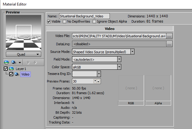

    Also if you meant thumbnails in the material manager that can be done in the material here.
    See Preview Frame "30" just change that to whatever you want.
