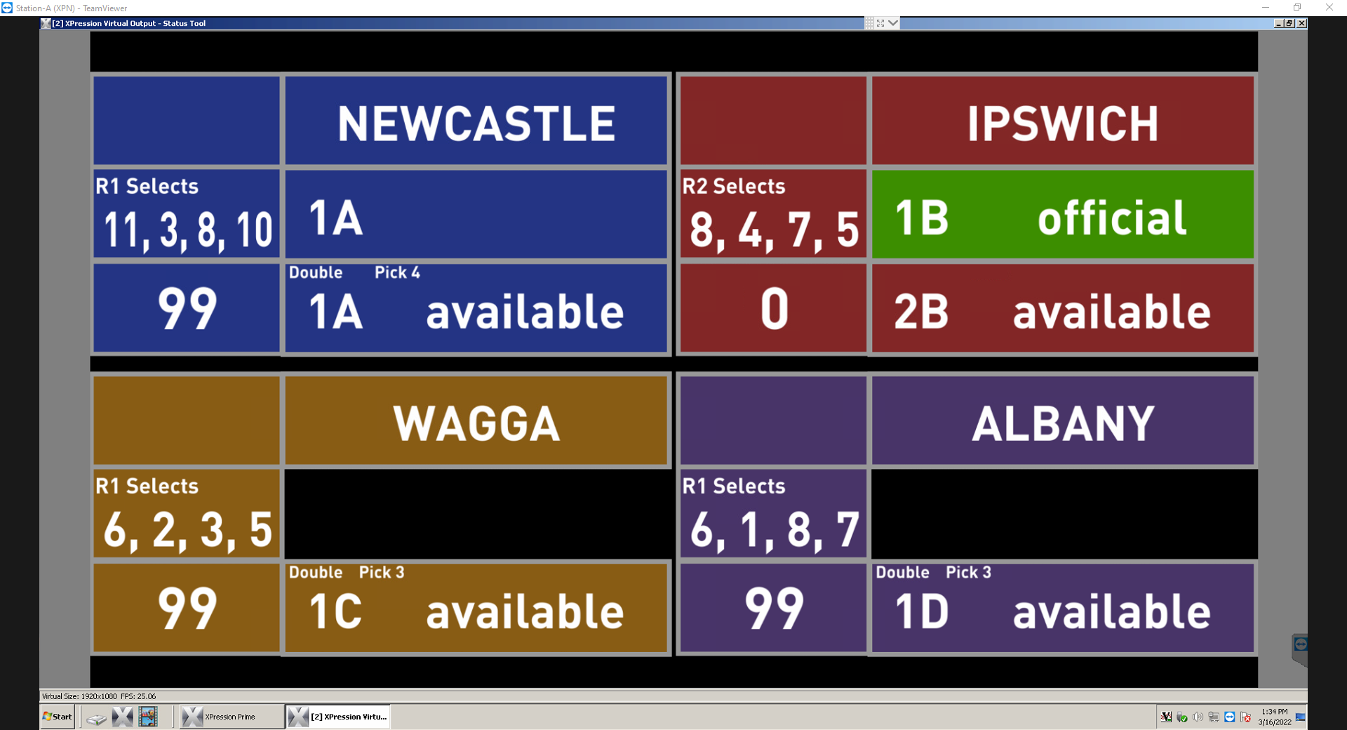

    In XPression, it's not really a preview that I want to see, it's a living status board that is just always live and giving relevant information to the operator using the same types of Datalinq and Visual Logic that our live production scenes are using.
    What you're saying would work (though the still frames might be quirky), but I would basically have to reset my UPNEXT after every action the operator takes to recreate the preview. Seems like it would be quite messy. (Also, XPression Prime might potentially be another limitation there)
    Attached an example of the scene/virtual output:
