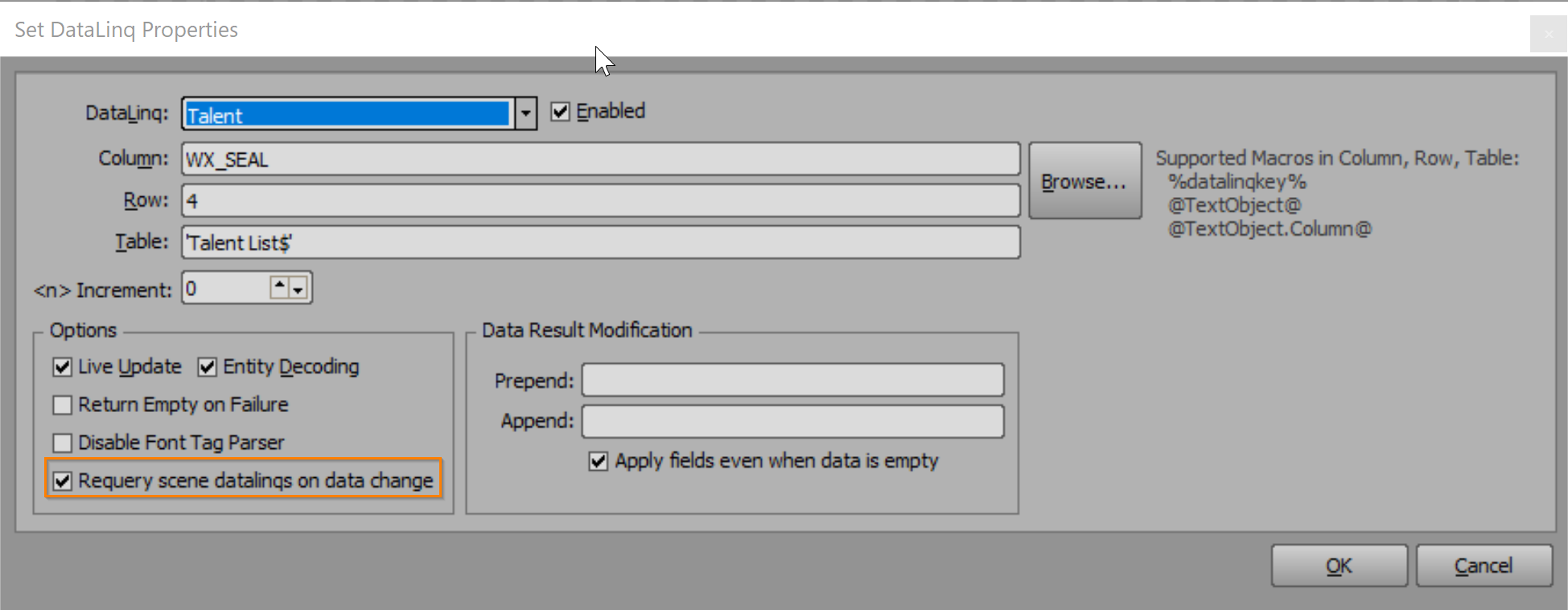

    Make sure to check the "Requery scene datalinqs on data change" box in the Datalinq properties of your Text Object if you plan to use it as a @TextObject@ macro on another object. This way if your data changes while the scene is on the air, the macros in other Datalinq or Dynamic Material paths will update as well.
