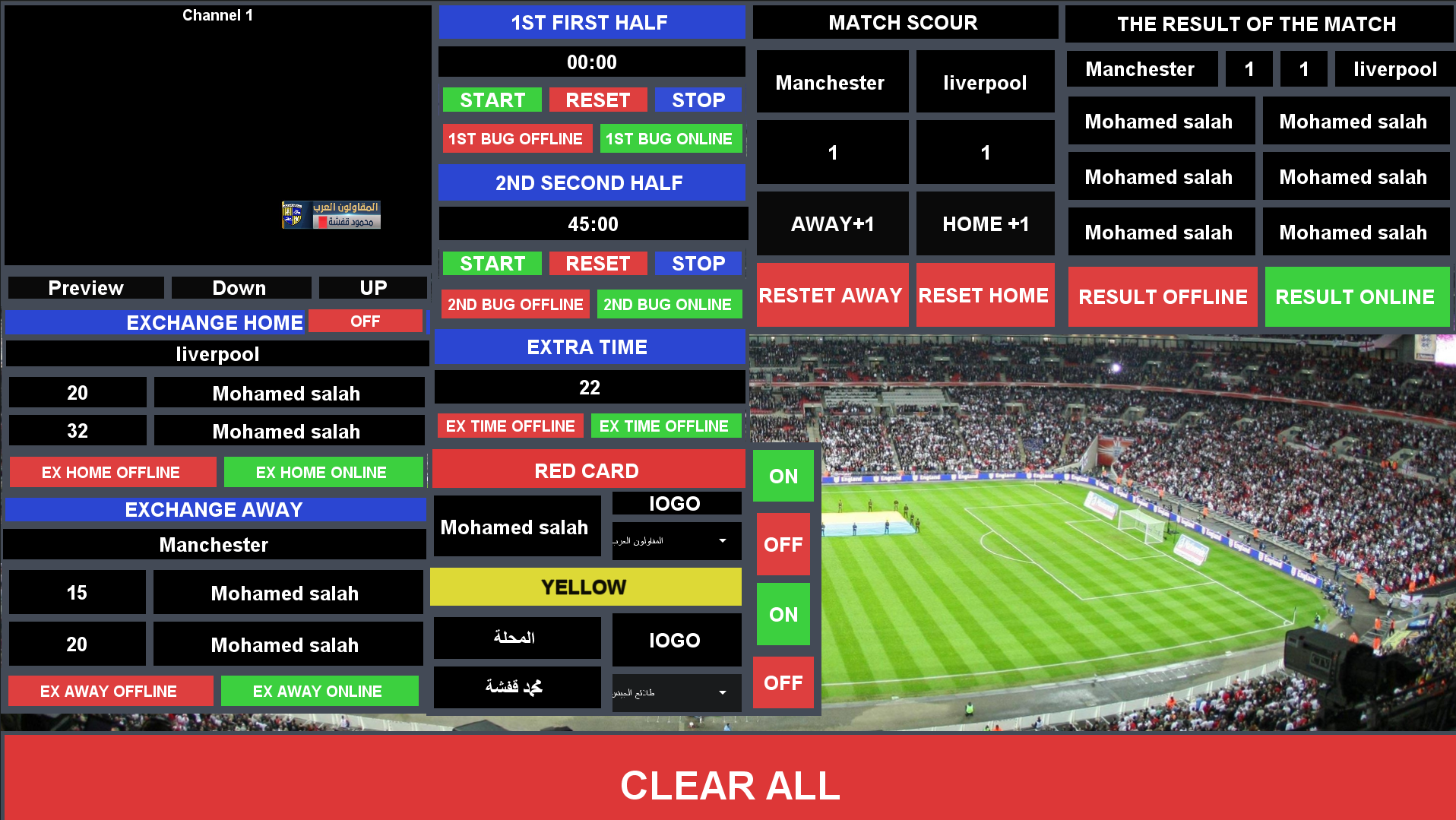

    i have anther way using Dashboard its very powerful

    Impressive!

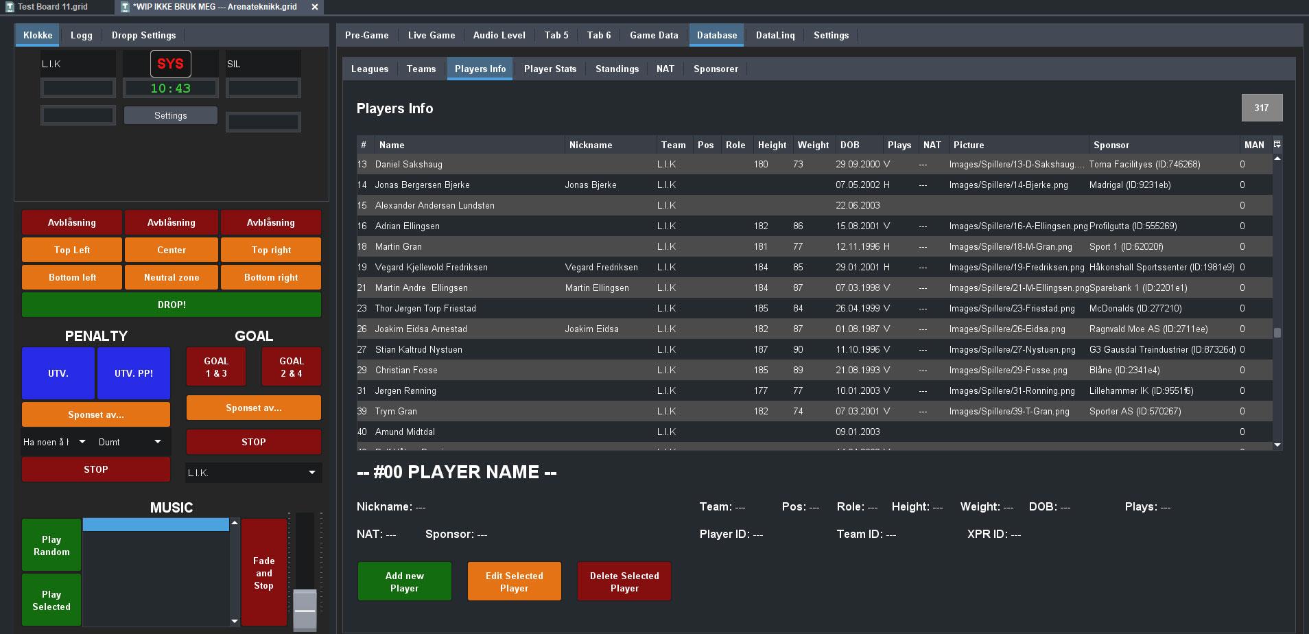

    I'd definetly recommend using DashBoard for what you're trying achieve here.
    This way you not only have the power of scripting behind you, but you can also create a DashBoard that really "anyone" can use with minimal training, and not having to be relying on that everyone knows your shortcuts etc.
    If you want to take this even a step further, if you decide to go for DashBoard, you can technically do calls to external sources like JSON etc and build tables of stats etc inside DashBoard and use those to create your graphics again. Even if you decide to use sources like Excel to handle the stats/info etc for players, you can then use that table, and a selector (like jersey number) in DashBoard to pull the data for that player into a graphics.
    Say you type in the jersey number 23, then that will go into the Excel sheet and fill out all the info you have on that player when the graphics goes online.
    Just an example. Hit me up if you want some clues and hints on this. Been developing this myself for the last few years for our local hockey team big screen.
    This DashBoard pulls data from external sources for stats and player info, listeners for live game clock feed, while talks to both Xpression, Graphite Mixer, Behringer X32 Audio Mixer, QLAB and through MIDI server also to our lighting board, controlling the entire venue from one panel.

    One word! WOW!
    That looks inspiring!
    Looks like the sky is the limit..
    I have the lastest Dashboard installed right now...gonna take a dive.

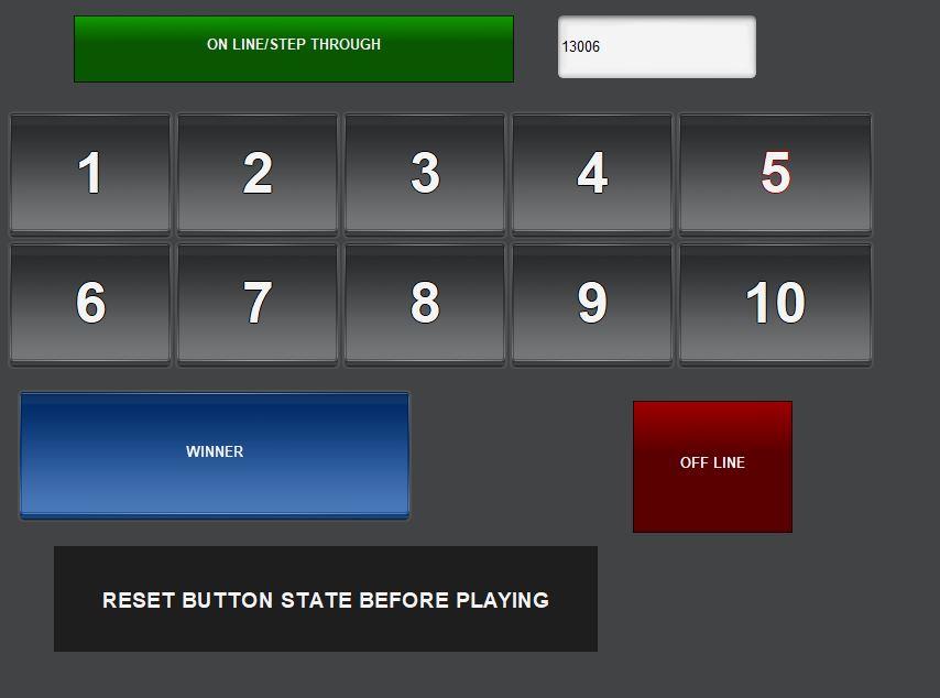

    Here is just a simple example of a dashboard I was working on Pre-Covid. By adding the Xpression API into my dashboard, I can run a fan game without ever touching the Xpression. In this example the green "On Line/Step through" button puts the scene online by using the API. The numbers 1 thru 10 use gpi triggers to fire animations in the game to turn the tiles over and back. The Winner button fires an animation via gpi to turn all tiles over, and display YOU WIN. Then the scene is taken off line with the "Off Line" button. All inside of the dashboard. The operator can run it, or a producer can.
