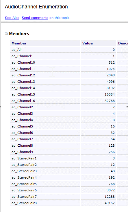

    For the SetVolumeLevel method (SetVolumeLevel(0, 0) – the first function is what audio channels to change the volume for, and the second function is to set the volume level. The range for volume level is 0 – 1.
    0 is 0%
    0.5 is 50%
    1 is 100%
    Ex.
    SetVolumeLevel(0, 0) would set all audio channels to 0%.
    SetVolumeLevel(3, 1) would set stereo pair 2 at 100%.
    For the audio channel function, here are the enumerations for different audio channels:
