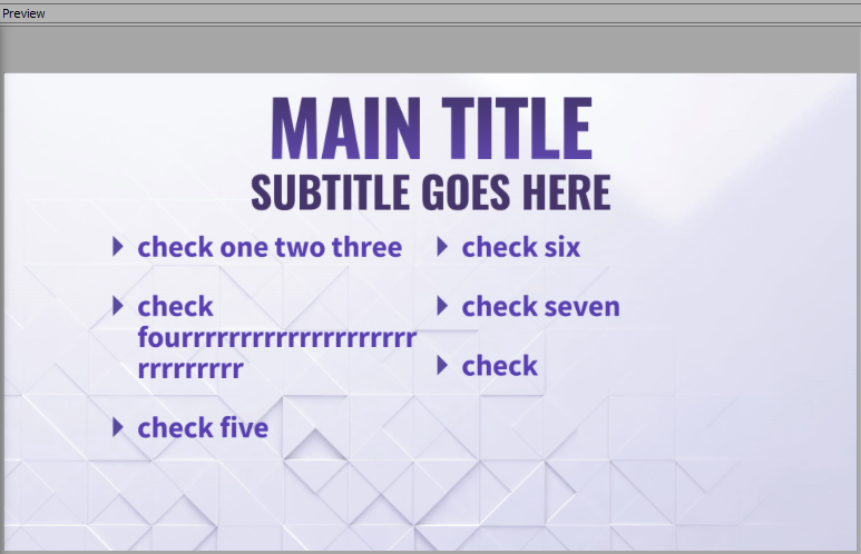

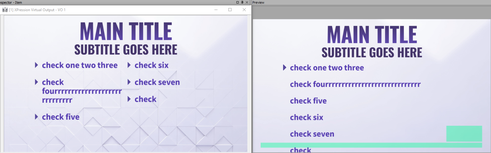

    I have built a rather extensive web of visual logic that behaves perfectly when in layout mode and when taken online. However, the preview seems to only be using the visual logic up to a certain point, and then behaves as if portions of it are disabled (comparison below, VO on the left, Preview on the right)...

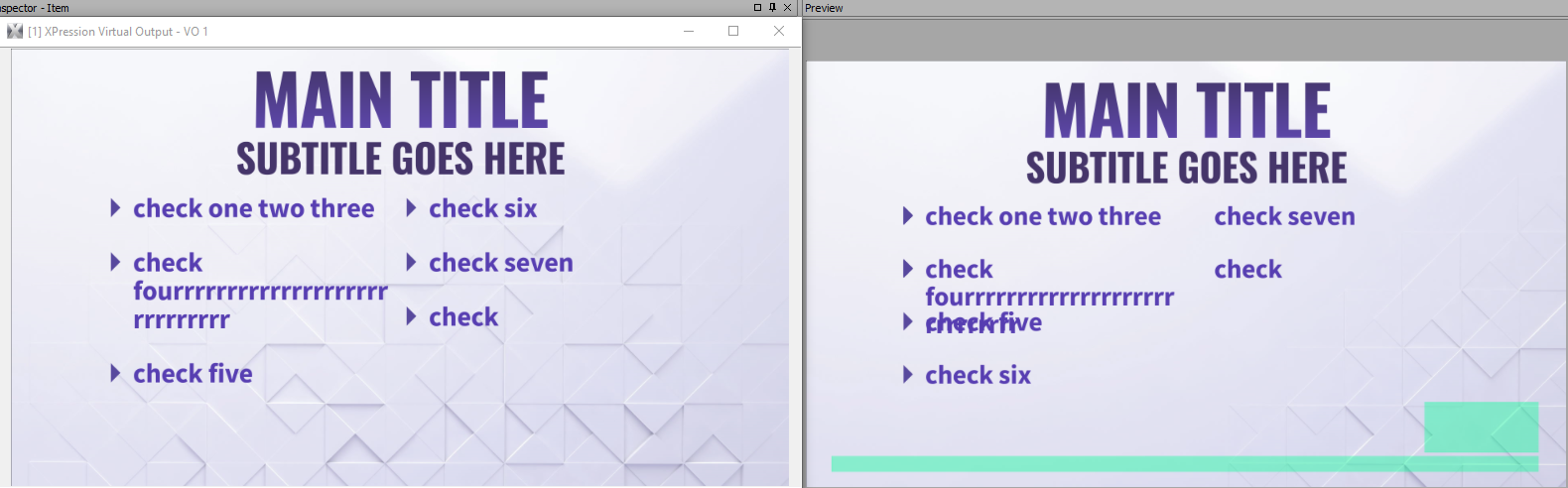

    While troubleshooting I moved tabs into different orders and this would cause different portions to not function correctly. Triangles are fixed, but spacing still fails (image below)...

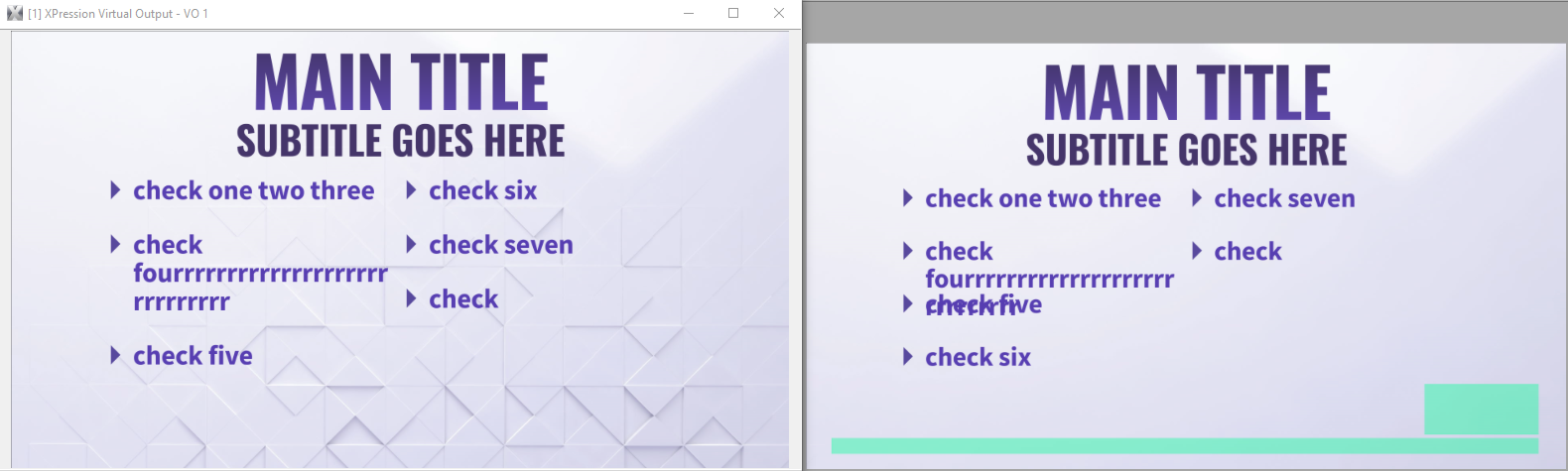

    Again, shuffled the VL tabs and different portions fail in preview only...

    The preview only renders one frame which is why you can see errors in the preview that are hidden when it plays back.
    I have had this before and I found changing the order of my tabs of visual logic can solve this issue.
    It's worth noting that visual logic renders the tabs from left to right in order.

    There's no limit as such, its just that you most likely have things dependant on other logic that is happening later, that's why you need to understand what is dependant on each other and have your tabs in the correct order.
  • 7.  RE: Visual Logic Failing for Preview Only
    Posted 02-23-2022 13:32
    Because not every task is getting completed within one frame.
    Most likely you have visual logic that's dependent on other visual logic blocks. If the logic runs that needs other logic to be completed in order to function itself it cannot run. The reason why you don't see this when the scenes play is that visual logic runs continuously so that logic is then able to run because the dependant logic gets run after then when XPression tries again that logic is now complete to run the other logic so it is successful in playback but not in preview because it doesn't try again as its only rendering 1 frame.
  • 8.  RE: Visual Logic Failing for Preview Only
    Posted 02-23-2022 14:09
    Ah, okay, I think I see what you're getting at. In Viewport and Online you're saying Visual Logic runs for frame 1 and probably has the same errors, but by the time frame 2 runs VL has essentially "stacked" a new run and fixes some of the order errors that must be in my logic.
