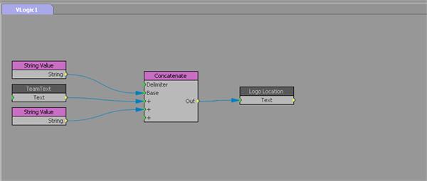

    Hey Everyone,
    I'm new to Visual Logic and trying to wrap my brain around using it for better functionality.
    I want to take a name from a Datalinq source, and use it to select a corresponding logo. For example: if the Datalinq source field is "Miami", I want the quad to display the "Miami" logo from my images folder. It would be at location: d:\\images\miami.png for example.
    Using Concatenate I am able to create the correct filepath text, but I can't figure out how to use that output to select the logo. Or maybe there is a better way to go about it? Any help would be appreciated. Thanks!

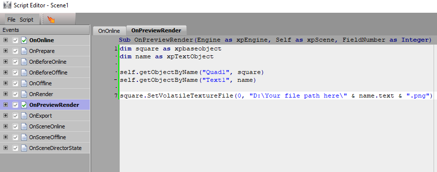

    Start to script by follow this video.
    https://www.youtube.com/watch?v=dppZSzdXl4c
    After that this will make sense.
    If you right-click and edit the script on your scene object and write this in OnOnline and OnPreview.
    dim square as xpbaseobject
    dim name as xpTextObject
    self.getObjectByName("Quad1", square)
    self.getObjectByName("Text1", name)
    square.SetVolatileTextureFile(0, "D:\Your file path here\" & name.text & ".png")
    Whatever is written in the object called Text1 will complete the path and set the first face on the object called Quad1.
    For example, if you wrote "Miami" in Text1 the path above would be "D:\Your file path here\Miami.png"

    Thanks Red. That worked!
    Appreciate the help!
