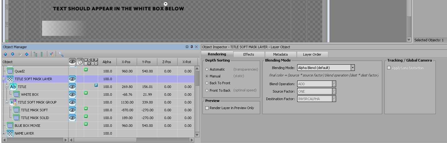

    It is 2D. Here is a snip of the object manager
    And here is a snip of the layer controls
    Any thoughts on what I'm doing wrong?
  • 4.  RE: Adding a mask to reveal Lower third with auto scale box
    Posted 03-19-2019 22:13
    Well, the White Box is below your text layer, so its 'above' it in the rendering order.
    So, there are 2 ways I know of to fix this:
    1 - move the White Box above your text in the hierarchy and and use VL to control the length of your box via the text's Bounding Box Width Scaled parameter.
    2 - Put a perspective camera in the scene and make it active (effectively making your scene live 3D space) and set your White Box's Z position to -1
