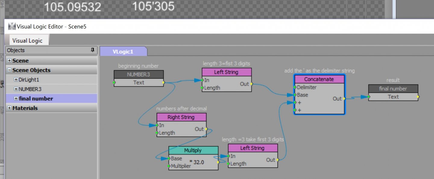

    If your number string is always going to be the same length you could use visual logic and do something like this.

    Here is a visual logic one if you'd like to try it

  • 18.  RE: Numeric conversion - DIFFICULT!
    Posted 06-20-2018 17:35
    Here you go
  • 19.  RE: Numeric conversion - DIFFICULT!
    Posted 06-20-2018 17:38
    Here you go!
  • 20.  RE: Numeric conversion - DIFFICULT!
    Posted 06-21-2018 13:35
    What values did you use for Format Float, String Value, Right String, Left String and Concatenate?
