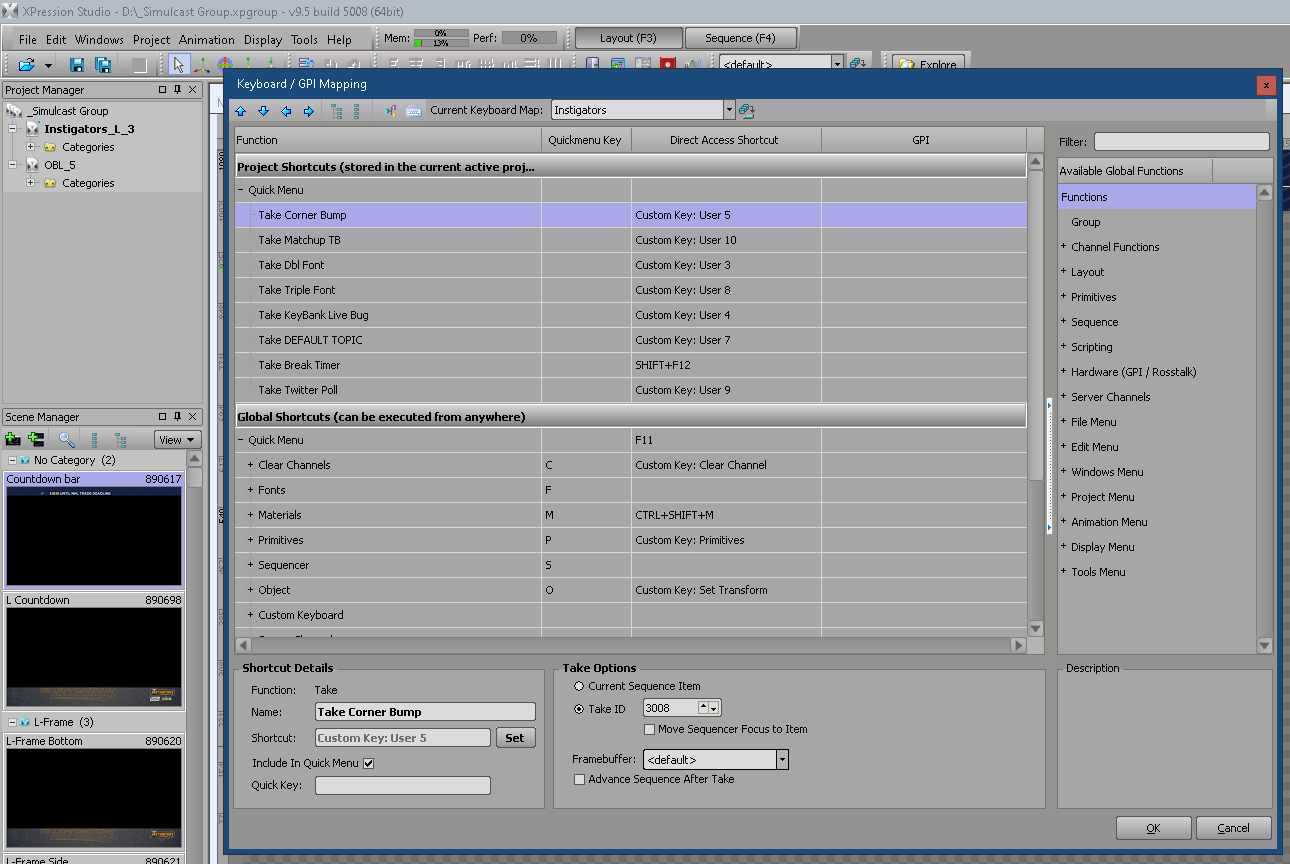

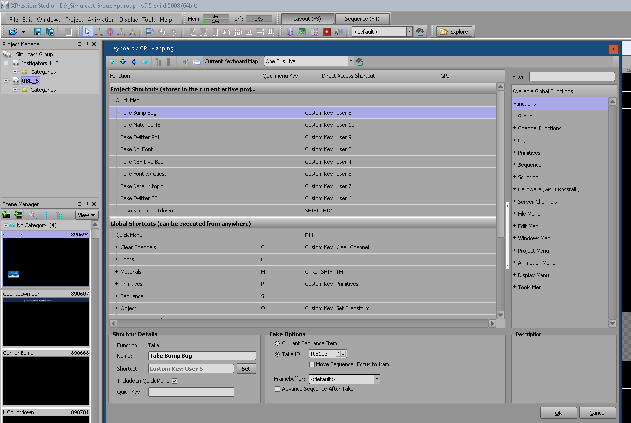

    I've been working on merging two projects for back-to-back shows into a single project group. Both projects use the XPression keyboard's User keys to Take particular Take IDs via keyboard mapping. I've made sure each project's Take IDs don't overlap with each other. I've saved one keyboard map with one project active, and a second keyboard map with the other active. I can change active projects and keyboard maps to see that the ID number has indeed been saved differently for each, but when I use the User keys, it appears to trigger both projects' Take IDs at the same time, rather than the selected keyboard map's and active project's assignment
    Does anyone know why this is behaving this way, and how I might go about fixing it?

    Would you mind sending a picture of how your project group is set up and your keyboard shortcuts?

    Sure, here you go
