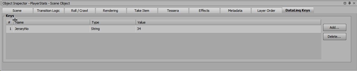

    You will need to set up “Datalinq keys” based on team (H or V) and jersey number. I’m on a job but might be able to dig into an older project for the Univ of Utah and take a few frame grabs for you.

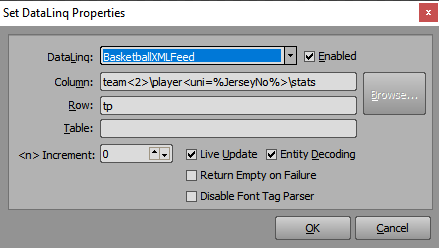

    Here is a screen shot of my feed using Datalinq key to populate Total Points from a stat crew file.
    The XML file from NLS IAU goes to a local shared drive for use in Xpression and Daktronics.  Before NLS, getting the XML file was quite painful as it was sent to Sidearm and I had a batch command that would run a software to search that FTP every so often and sync.
