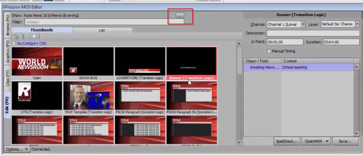

    The category feature on Project Server is for a workflow feature called Project Server Styles, what you describe here should not be using that feature. I would delete the category you have created on the Project Server (carefully).
     It sounds like you have created a new Project file with these new scenes. In that case, you should create a new SHOW on the Project Server. Once you have published to that Show on the Project Server you can open it in the MOS plugin by clicking the "Browse" button (3 dots):
    From there you'll be able to open different projects on your project server in the MOS plugin. You can have multiple shows/projects in your MOS rundown. The Preview Engine and Studio/BlueBox Output Engines can load multiple projects simultaneously.
