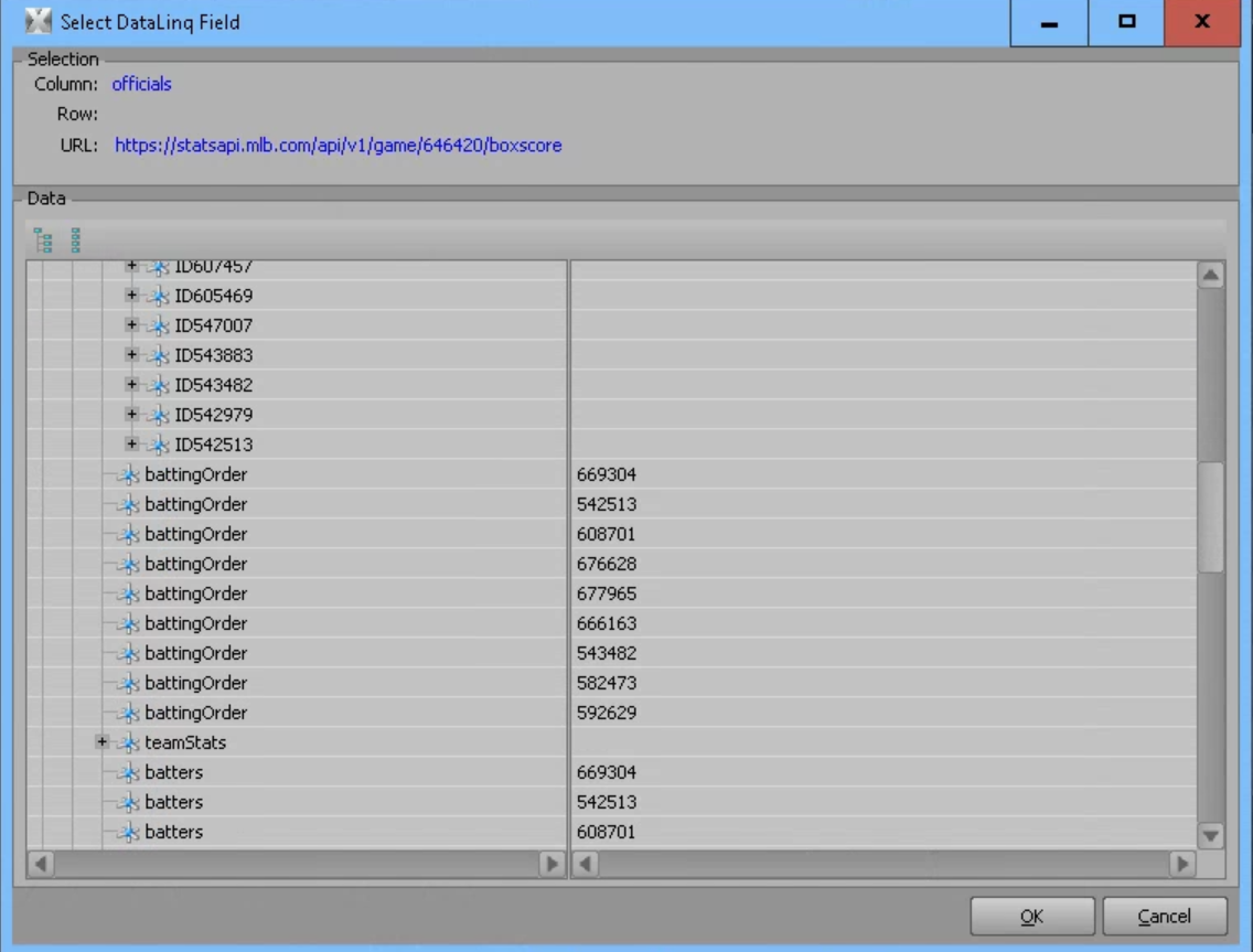

    So would it look like this
    teams\home\players\"ID"+<battingOrder>
    I put a pic in t make sure I am explaining things right.
    I need to pull the batting order value in and append "ID" for the node above that.
    Josh Udvig
    CTN STUDIOS - COON RAPIDS

    Posted 03-01-2022 12:46
    From the 2nd column from the batting order node in the pic.
    Josh Udvig

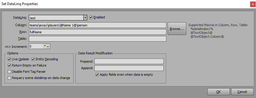

  • 6.  RE: Json Filters in dataling
    Posted 03-01-2022 12:55
    One way is to have a datalinq tied to the number filed you want and preappend the data with ID
    The you can use a macro to complete the other datalinqs like this.
    So my text object that has the innitatial datalinq is called Name 1 but you just put whatever the text object name is between the @@ but I am not sure if that's tidier than what you are doing with the visual logic.
    I'll try some other things as well. ​
