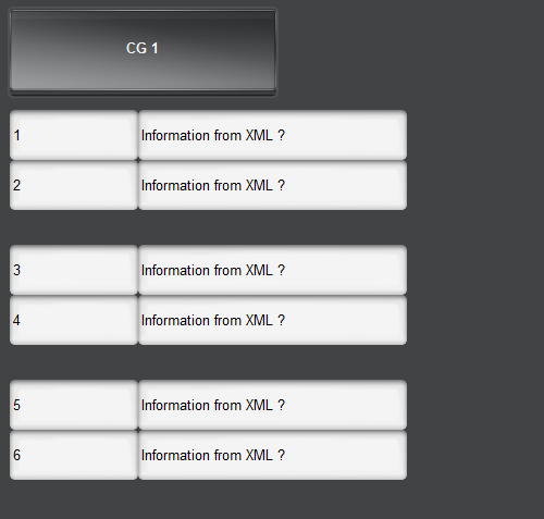

    Hi Everyone I have created a user interface and I want to link an XML File.
    I would like to write an ID in the right column and automatically retreive the linked information in the right column.
    How can I do that ?

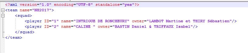

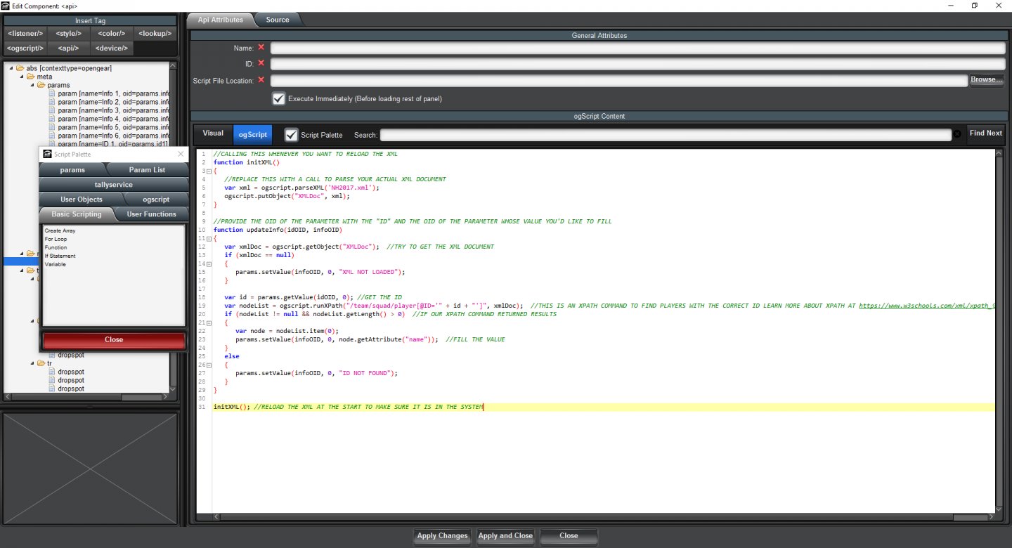

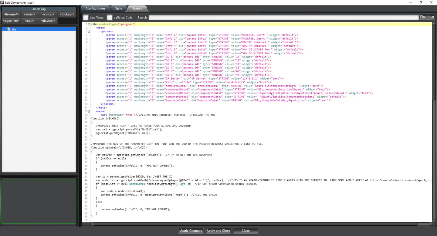

    I have replace your XML suite by my XML File (place it in the same folder than my pannel). It doesn't work . Here is the code.
    An Idea ?

    I just add ' ' at my file name. But Doesn't Work
    var xml = ogscript.parseXML('NH2017.xml');
  • 8.  RE: XML link in paramteters
    Posted 03-16-2017 19:07
    Put quotes around your file name.
  • 9.  RE: XML link in paramteters
    Posted 03-16-2017 19:08
    Can you upload a copy of the XML file?

    The problem is that your XML is not valid.
    Your file contains this:
    <player ID="2" name="CALINE " owner="BASTIN Daniel & TRIFFAUX Isabel"/>
    The problem is that "&" is reserved in XML so it needs to be escaped to:
    <player ID="2" name="CALINE " owner="BASTIN Daniel &amp; TRIFFAUX Isabel"
  • 12.  RE: XML link in paramteters
    Posted 03-16-2017 19:27
    Waouw . . It works. It still thing to do with this pannel. Retriev Name in one Cell and owner in a second one.
    Great thanks you save me a lot of time.

    I'm near the end but I block on one thing. I would like to display in even rows the name (of the ID) and in the odd rows the owner. I don't find in the code How could I do that.
    In fact this Template represente the 3 first of a category. For each winner i have to display the name in the first row ans the owner on the second one.

          <api immediate="true">//CALLING THIS WHENEVER YOU WANT TO RELOAD THE XML
    function initXML()
       //REPLACE THIS WITH A CALL TO PARSE YOUR ACTUAL XML DOCUMENT
       ogscript.putObject("XMLDoc", xml);
    //PROVIDE THE OID OF THE PARAMETER WITH THE "ID" AND THE OID OF THE PARAMETER WHOSE VALUE YOU'D LIKE TO FILL
    function updateInfo(idOID, infoOID)
       var xmlDoc = ogscript.getObject("XMLDoc");  //TRY TO GET THE XML DOCUMENT
       if (xmlDoc == null)
          params.setValue(infoOID, 0, "XML NOT LOADED");
       var id = params.getValue(idOID, 0); //GET THE ID
       var nodeList = ogscript.runXPath("/team/squad/player[@ID='" + id + "']", xmlDoc);  //THIS IS AN XPATH COMMAND TO FIND PLAYERS WITH THE CORRECT ID LEARN MORE ABOUT XPATH AT https://www.w3schools.com/xml/xpath_intro.asp
       if (nodeList != null &amp;&amp; nodeList.getLength() &gt; 0)  //IF OUR XPATH COMMAND RETURNED RESULTS
          var node = nodeList.item(0);
          params.setValue(infoOID, 0, node.getAttribute("name"));  //FILL THE VALUE
       else
          params.setValue(infoOID, 0, "ID NOT FOUND");
    initXML(); //RELOAD THE XML AT THE START TO MAKE SURE IT IS IN THE SYSTEM</api>

  • 16.  RE: XML link in paramteters
    Posted 04-13-2017 09:00
    Hi James
    I am trying the same method with the code you provided. I am trying to create the same schema as above but my dahsboard keeps saying "ID NOT FOUND"
    Any suggestions?
  • 17.  RE: XML link in paramteters
    Posted 05-10-2017 08:59
    Hi James, I am having trouble reading my XML Into dashboard. I am using the above given script. It is not allowing me to upload my XML saying that it is an invalid document

  • 18.  RE: XML link in paramteters
    Posted 05-10-2017 13:33
    Schema1.zip This is my Schema
  • 19.  RE: XML link in paramteters
    Posted 05-10-2017 14:55
    It looks like you were pasting the entire XML document into the script source editor.
    To use the snippet, you'll want to paste it into the "Source" tab of a blank custom panel. You can then grab the code and take a closer look.
