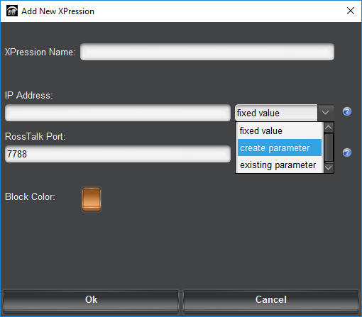

    Hi Al.
    While you can write a script that will update (temporarily) the host table: (ogscript.putPrivateString('hosts', 'DEVICE_ID.host', 'NEW_IP_ADDRESS');
    A better approach for what you're trying to achieve is to use the "create parameter" option when you add your XPression device to your panel. When you do this, the value of the parameter will always be used as the IP Address for the XPression commands.

    Hope that helps.
    James
