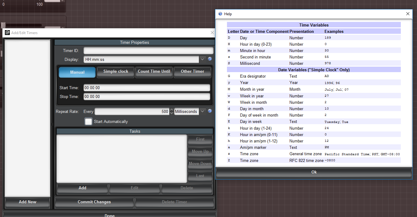

    However, the timer turns out to be somewhat of an issue. The smallest "counter" in a timer is 1 second, even though I can push the update time lower than the 500ms that is by default.
    This isnt accurate enough in order to hit the "rythm" these cuts are supposed to be. One-tenth of a second would be good enough. Getting one hundred of a second seems a bit overkill or just impractical with how often the timer would have to update the parameter showing the timer.
    Is there any way to go below just "ss" and go into milliseconds (ss.sss) instead? Or at least show one decimal?
    Trying this in the "pattern" value in the timer code just turns what should be the milliseconds into seconds instead.

    And ONCE again! Not relying in the GUI and reading more in the documentation I could've avoided asking this question alltogether..!
    That and not relying too much on previous coding experience where the syntax is slightly off of course...
    Simply add an S, and not sss to the setup of the timer and voila... milliseconds... Fun stuff this!
    Goal of this week... Read the entire ogScript Reference book, start to finish... Not just light skimming this time.

    Glad you got it working, @astralsberg.
    For this one, you also might find the little "help" button (question mark in a blue circle) next to the Display field in "Timers" handy - it lists all of the different fields you can use.
