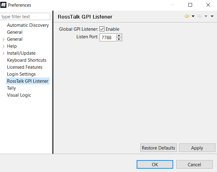

    1. We need to enable GPI trigger(Go to Windows < Preferences < Ross Talk GPI listener)

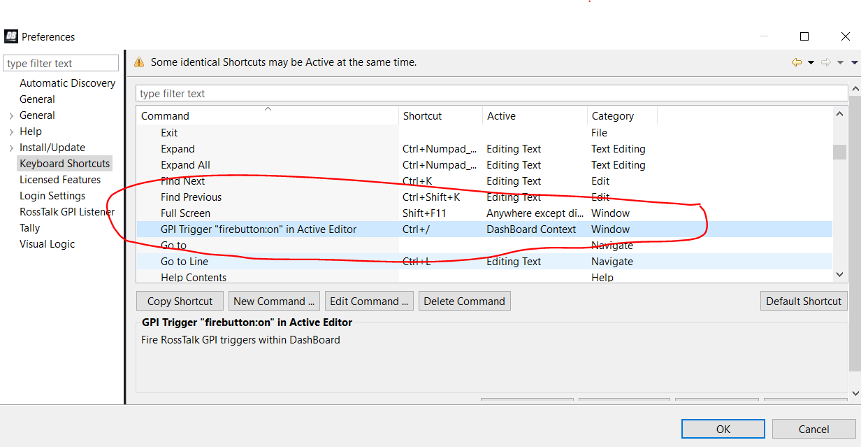

    2.  Create GPI trigger shortcut to trigger it. (I have created GPI short cut -firebutton(shortcut-Ctrl+/) only for active editor or context

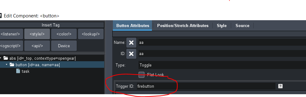

    3. Then at last in your panel add that GPI trigger ( please find the panel source code below) , Here I have created a button then added firebutton which is my GPI trigger name into trigger id as shown below
    4. Then I have added a debug task to show whether button is actually pressed or not
    <button buttontype="push" gpi="firebutton" height="110" id="aa" left="180" name="aa" top="192" width="163">
    <task tasktype="ogscript">ogscript.debug("fired");
    </task>
    </button>
    Let me know if this helps or not
