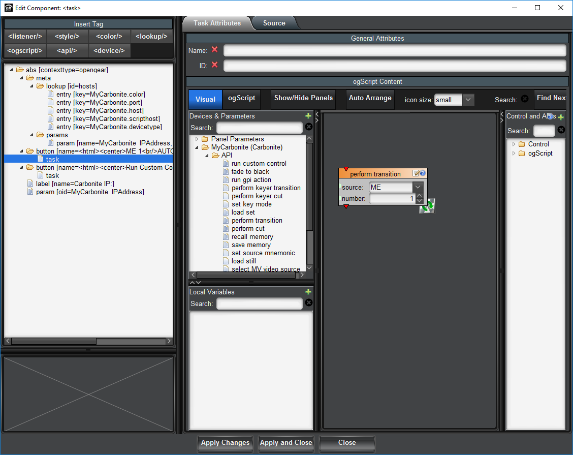

    You can find a list of the most common commands inside of Visual Logic. [LIST=1]
    • Create a Custom Panel
    • Add a button to the custom panel
    • Add a task to the custom panel
    • Add a device to the task (green "+" icon on the left side of the page)
    • Use the "Create Parameter" option for the IP Address
    • Select "ok" and expand the "API" node in the tree.
    Here is a basic example of a panel that can run a custom control or perform a transition on an ME:
       <meta>
          <lookup id="hosts">
             <entry key="MyCarbonite.color">-1145302</entry>
             <entry key="MyCarbonite.port">7788</entry>
             <entry key="MyCarbonite.host">params.getValue('MyCarbonite_IPAddress', 0)</entry>
             <entry key="MyCarbonite.scripthost">true</entry>
             <entry key="MyCarbonite.devicetype">Carbonite</entry>
          </lookup>
          <params>
             <param access="1" maxlength="0" name="MyCarbonite_IPAddress" oid="MyCarbonite_IPAddress" type="STRING" value="SWITCHER_IP_ADDRESS" widget="0"/>
          </params>
       </meta>
       <button buttontype="push" height="228" left="17" name="&lt;html&gt;&lt;center&gt;ME 1&lt;br/&gt;AUTO&lt;/center&gt;&lt;/html&gt;" top="17" width="305">
          <task tasktype="ogscript">/*! block id=1004 !*/
    rosstalk.sendMessage(params.getValue('MyCarbonite_IPAddress', 0), 7788, "MEAUTO ME:" + 1);
     &lt;block id="1004" type="MyCarbonite_carbonite_transition" x="10" y="100" w="243" MESRC="ME" MENUM="1" /&gt;
    /*!!&lt;checksum&gt;9641aec170b7ac6cdd2ee7db9b48b11d&lt;/checksum&gt;!!*/</task>
       </button>
       <button buttontype="push" height="228" left="327" name="&lt;html&gt;&lt;center&gt;Run Custom Control&lt;br/&gt;Bank 1&lt;br/&gt;CC 1&lt;/center&gt;&lt;/html&gt;" top="10" width="305">
          <task tasktype="ogscript">/*! block id=1005 !*/
    rosstalk.sendMessage(params.getValue('MyCarbonite_IPAddress', 0), 7788, "CC " + 1 + ":" + 1);
     &lt;block id="1005" type="MyCarbonite_carbonite_runCC" x="41" y="102" w="243" BANK="1" CC="1" /&gt;
    /*!!&lt;checksum&gt;b2aa5fb5f2c39ce13ff11c57accbed2c&lt;/checksum&gt;!!*/</task>
       </button>
       <label height="45" left="20" name="Carbonite IP:" style="txt-align:east" top="259" width="201"/>
       <param expand="true" height="55" left="226" oid="MyCarbonite_IPAddress" top="254" widget="3" width="383"/>
