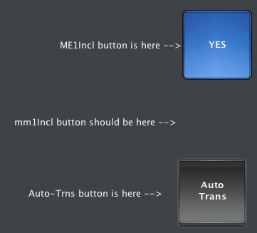

    And the screenshot of the results:

    Unfortunately, there is not much of a User Interface in Panel Builder for handling this but there are a few ways to work around it.
    One fairly simple way (if you're using DashBoard 8.0 Beta) would be to add an id to your top-level context and then add the new contextid attribute to your missing param tag:

    Another option would be to just make your entire panel point to the Carbonite. The downside of this approach is that UI tools for adding new parameters will disappear (you'l have to manually add them in the XML). The upside is that the overall code is a bit cleaner:
