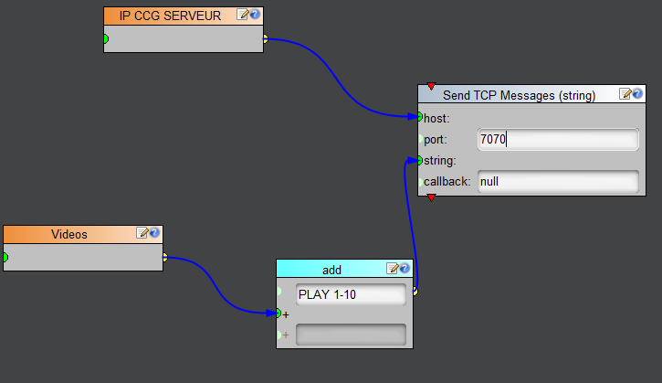

    Hi;
    I work actually on a Custum pannel to send tcp message string. I have a parameter with value and name. But in visual logic when I want to use the selection it is the value and not the name. Is it possible to use the name or ton convert value in string ?
    Is it possible to use that with an XML ? At the end I would like to use that with 100 value to recall a specific string. It is easyer to add 100 value in an XML than type one by one
  • 2.  RE: Convert Value in string
    Posted 03-08-2017 20:48
    Unfortunately, Visual Logic only currently supports getting the parameter value and not getting the value as a String.
    Your best option is to replace your current Visual Logic code with this line of ogScript:
    rosstalk.sendMessage(params.getValue('IP_CCG_SERVEUR', 0), 7070, ("PLAY 1-10 " + params.getValueAsString('Videos', 0)), null);

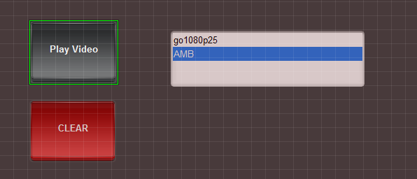

    great Thanks. Is it an exaggeration to ask your help once again ?
    I would like to list files from a folder and have it on my custom pannel. I should be the 'VIDEOS' params

    Posted 03-08-2017 22:01
    In the code I gave you, the OID was lower-case "loop". In yours, it is upper-case "LOOP".
    As for your last question (about listing the files in a directory), assuming you just want to list the files and not directories, you can use the following code (note, you would replace file:/c:/ with the full path to the directory you wish to list)
    var choices = [];
    var file = ogscript.getFile("file:/c:/");
    if (file != null)
       var subFiles = file.listFiles();
       for (var i = 0; i < subFiles.length; i++)
          if (!subFiles[i].isDirectory())
             choices.push(subFiles[i].getName());
    var constraint = params.createIntChoiceConstraint(choices);
    params.replaceConstraint('Videos', constraint);
