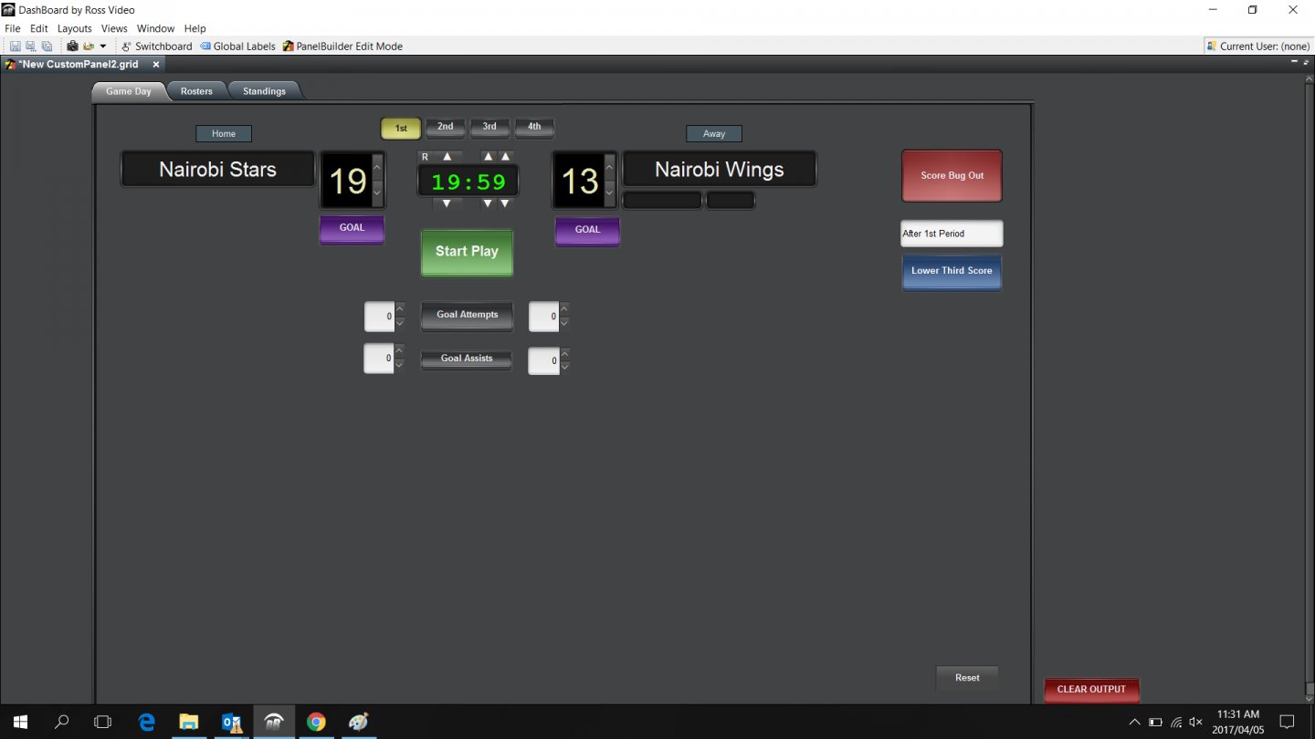

    Just a quick question, I am creating these match stats as seen on my screen grab. Next to 'Goal Attempts" could you help out with the coding in terms of adding stats, the toggle box? I am using Chris Kaptein's Scoring app as my backbone however it will not allow me to cope and paste the script
  • 7.  RE: Scoring App On Dashboard
    Posted 04-05-2017 13:45
    Hi Dennis.
    In your screen grab, I see 2 numeric spinner controls (one on either side of "Goal Attempts"). I'm not sure which toggle you are talking about though.
    In his case, what we'd want to determine is what exactly you need the script to do:
    Setting parameter values?
    Taking an XPression Take ID to air?
    Clearing a Take ID?
    James

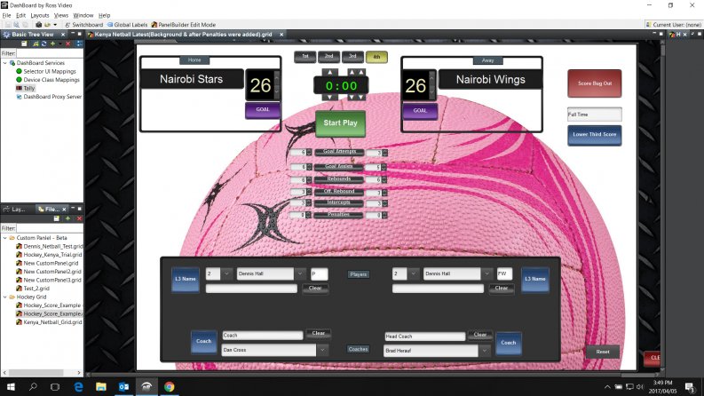

      Dennis - Hi James
      after a bit of playing around, I managed to get it right.
      I am now stuck with the dilemma of connecting Dashboard to Xpression.
      Please have a look at the screen grab I have now attached.
      I need those stats to go live to air as well as the Lower Third names.
      My problems are
      - Xpression is not run locally, it will be on the network (not on my PC)
      - I need stats to update continuously so they're available to go to air
      - Does the dashboard panel constantly write to a XML to update stats?
      So out of all of those questions, the main one is how to get Xpression graphics to read dashboard and output to air.
      Cheers
      Dennis
