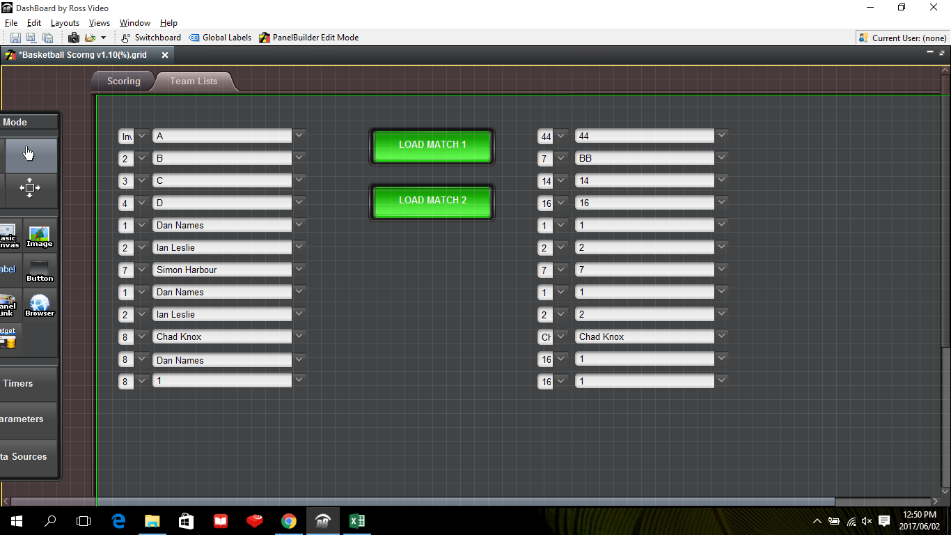

    Thank you for this. It works very well. I have a related question, please see the images.
    I have created a separate tab to load players for each match, I now would like to add the players to my main scoring TAB but as READ ONLY bars. For some reason this is not possible, do you have any suggestions?
    Picture 1: Showing how I have created my dropdowns which function well

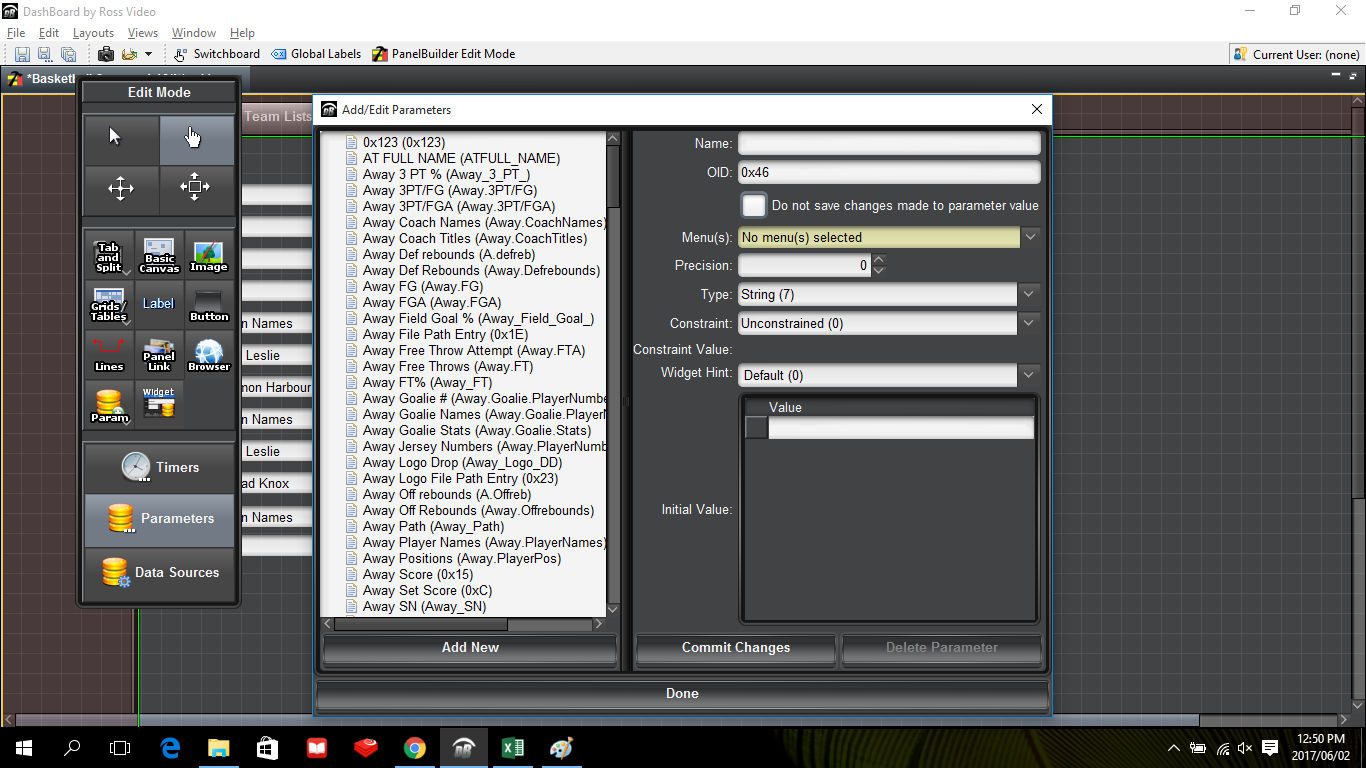

    Picture 2: My parameter window does not show the parameters.

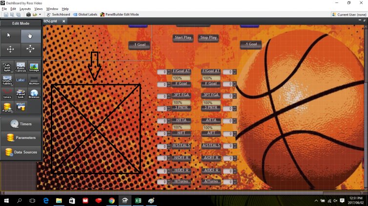

    Picture 3: Where I would like to put all players in 'Read only'
