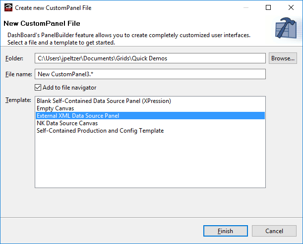

    If you want to create a new panel that uses an XML data source, select "External XML Data Source Panel" as the template when creating a new Custom Panel.

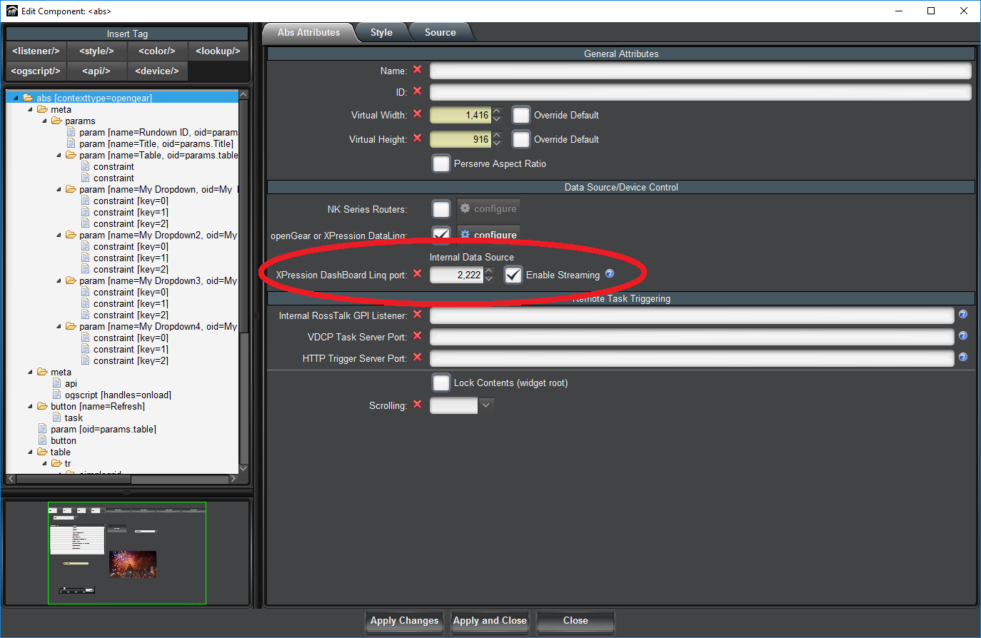

    If you are looking to use DataLinq for your panel parameters, you are better off using the "DashBoard DataLinq" source in XPression and enabling parameter streaming inside of DashBoard.

    @jamespeltzer. Thanks James, making an external xml source does the trick. I'm making much better progress now that it actually works. Thank you.

    The external XML will work for you but it is considered the 'old way' of doing things. The advantage of the streaming mechanism is that is actually updates XPression faster and does not need to be on the same computer as the DataLinq server.

    @jamespeltzer Where can I find the panel inside of dashboard to enable streaming? There is so little documentation. I've downloaded and printed the Development guide but it would be nice to have project to work along.
  • 11.  RE: Dashboard Newby (no xml file for custom panel)
    Posted 12-07-2017 22:54
    James, thank you for the link. Now I can start enjoying dashboard. I do in game CG design for an NBA team and this is going to make our operator much calmer on game nights.
