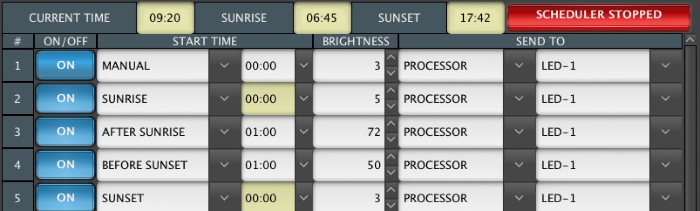

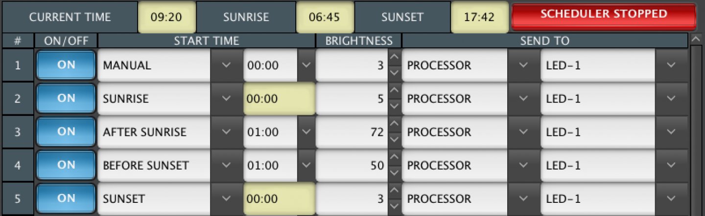

    Hey James, I did run into one issue. When I go into Panel builder mode and I edit any object in the panel, then "Apply and Close" it changes the widget. When I change param (a) to set it back to editable it stays Read-Only until I refresh the page (F5). See attached screenshots.

    I specify the hint in the parameter. I have an API set up to trigger the read only, then in each drop down menu I reference that API on change, it also take affect on load. Right now I have 2 params that are stuck on read only. I had to go into the "source" code of the param and add back in access. See below examples.
    Working Param
    <param access="1" colspan="1" expand="true" fill="both" maxlength="0" oid="S.START.01" precision="0" rowspan="1" weightx="1.0" weighty="1.0">
                      <config key="w.format">HH:mm</config>
                      <config key="w.restricted">true</config>
                      <task tasktype="ogscript">updateSchedulerArrays();</task>
                      <task tasktype="ogscript">%const['GlobalFunctions']['SetTime']%
    SetTime()</task>
                   </param>
    Non-working Param
    <param colspan="1" expand="true" fill="both" oid="S.START.05" precision="0" rowspan="1" weightx="1.0" weighty="1.0">
    SetTime()</task>
                   </param>
