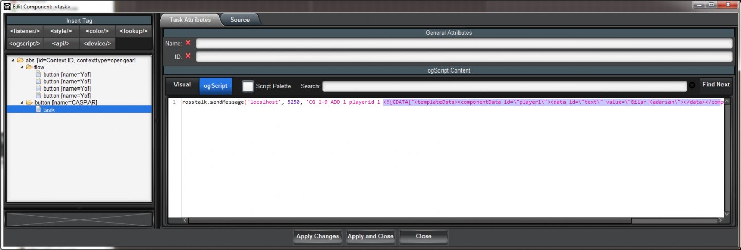

    <button buttontype="push" height="101" left="56" name="CASPAR" top="132" width="198">
    <task tasktype="ogscript">rosstalk.sendMessage('localhos t', 5250, 'CG 1-9 ADD 1 playerid 1 &lt;![CDATA["&lt;templateData&gt;&lt;componentData id="player1"&gt;&lt;data id="text" value="Gilar Kadarsah"&gt;&lt;/data&gt;&lt;/componentData&gt;&lt;/templateData&gt;"]]&gt;');</task>
    </button>
    Yes, this is incredibly ugly. The good news is, in the UI, it looks like this:
