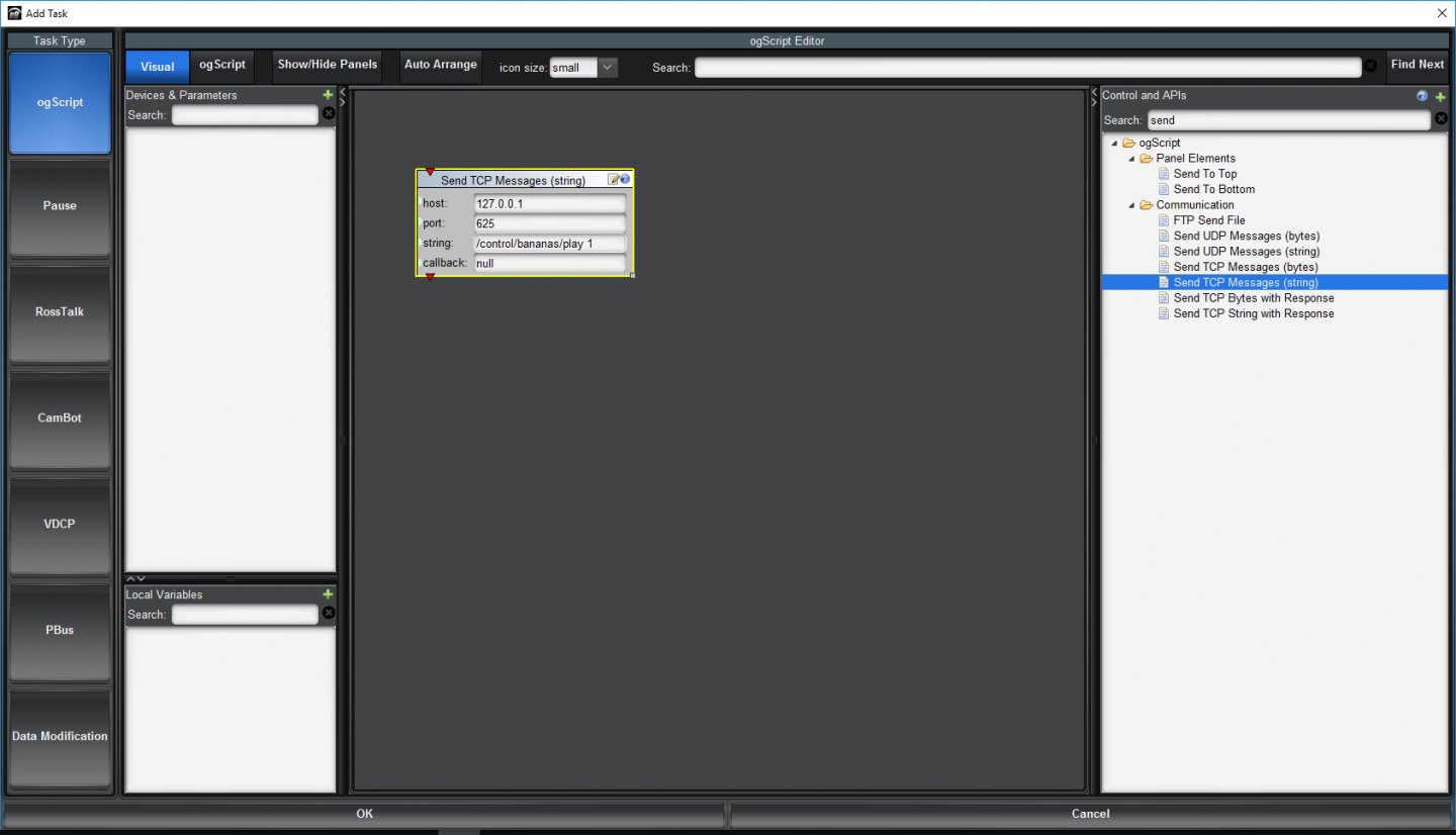

    You can also find these commands (for both TCP and UDP) in DashBoard's Visual Logic (just type "send" into the "Control and APIs" search field and you'll see them listed):

    To be honest I have not played with the visual logic stuff yet, This gives me a reason to try!
