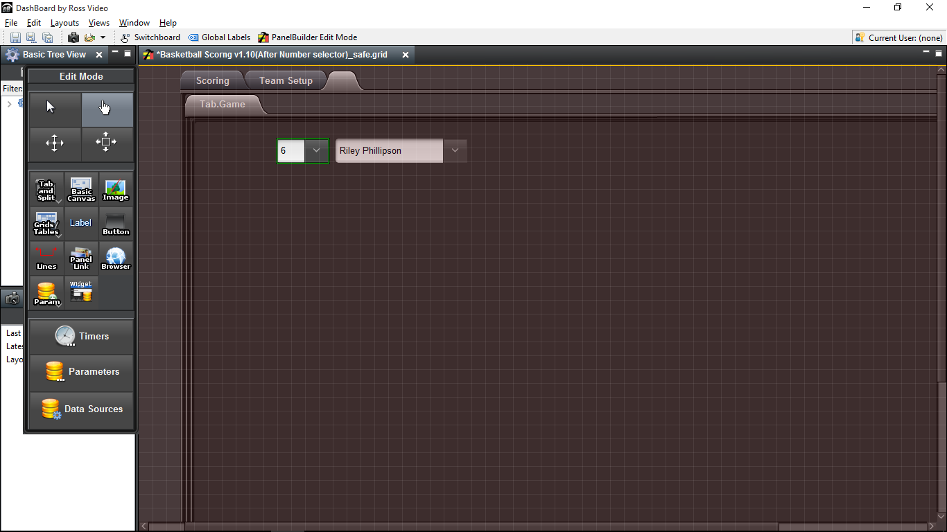

    I want to use one Xpression template for ll my name straps
    I want to link my drop down menu to my XML source so that when I select a player number, It automatically matches to the name in the XML Document.
    I have attached a few screenshots as well as my XML.
    Cheers

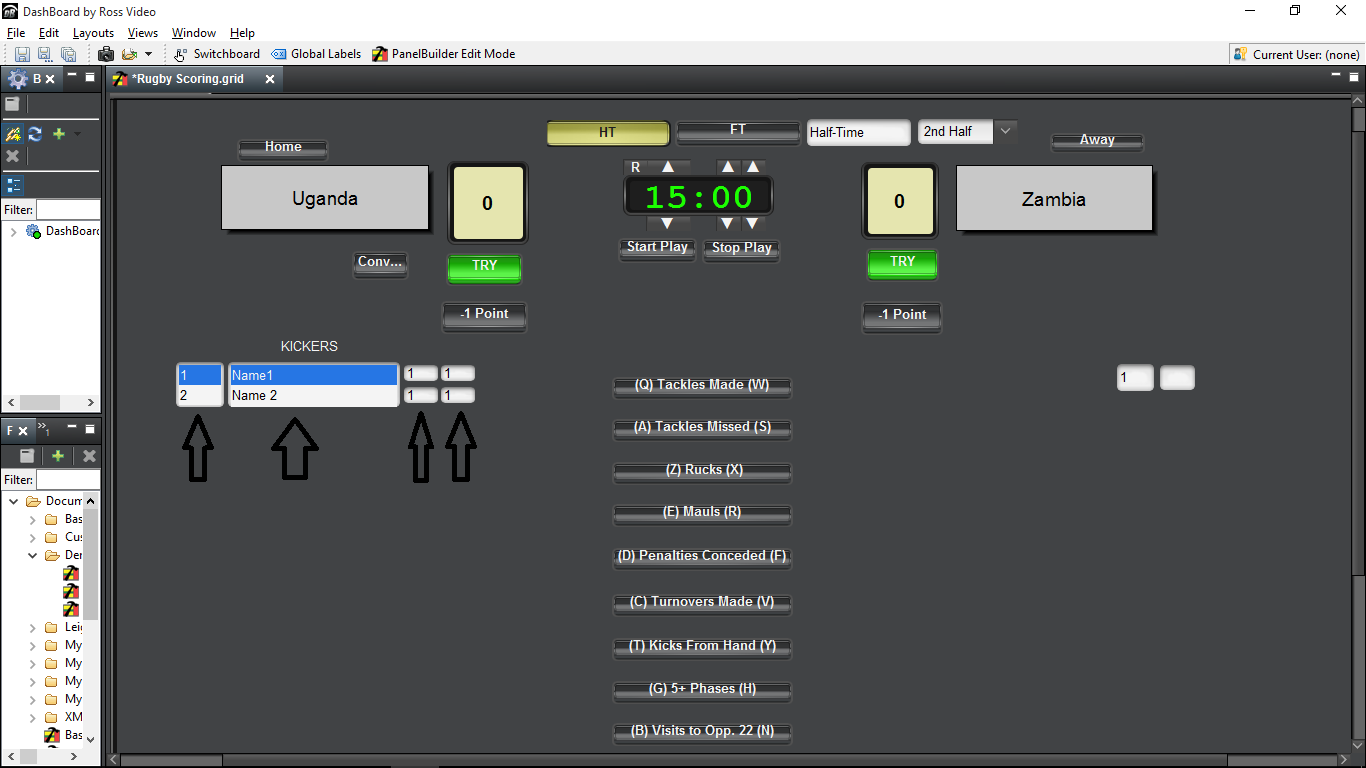

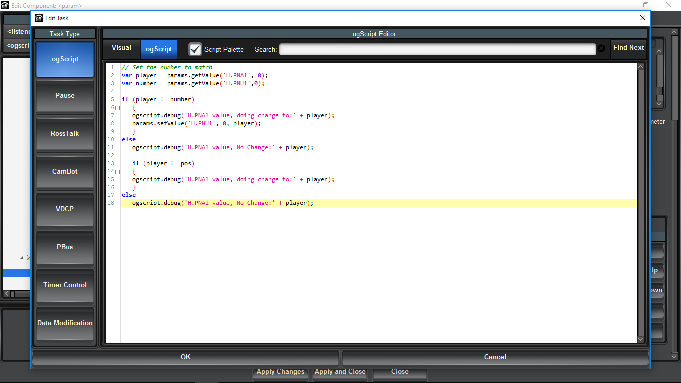

    In the above example you gave me, it links to parameters, is it possible to link more than 2? I have tried but it does not seem to work. I have attached an example of the 4 that id like to link.
    any advice would be great.
