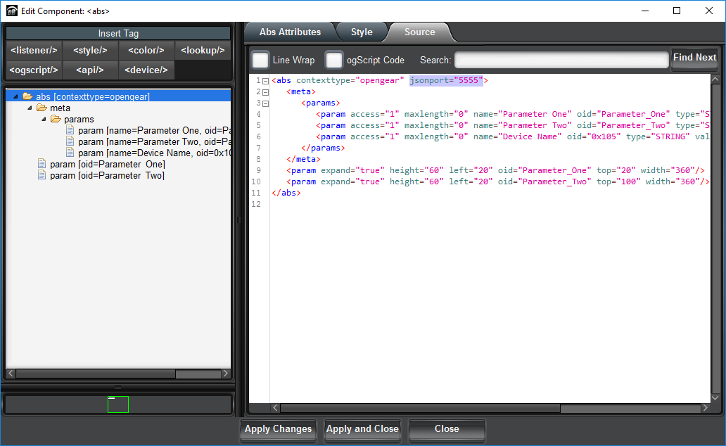

    Data Provider:
    <abs contexttype="opengear" jsonport="5555">

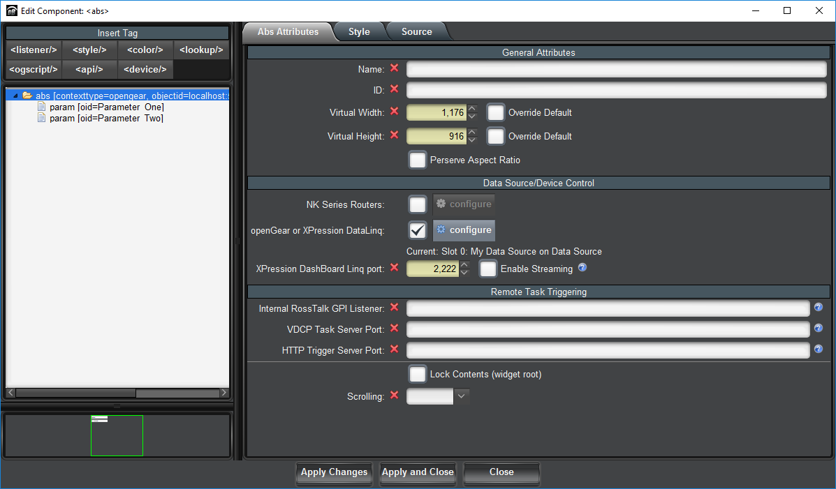

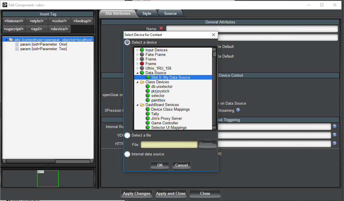

    Data Consumer (assuming I have selected port 5555 for the virual device and have it on "localhost"):
    <abs contexttype="opengear" objectid="localhost:5555&lt;br&gt;Slot 0&lt;br&gt;My Data Source" objecttype="My Data Source">

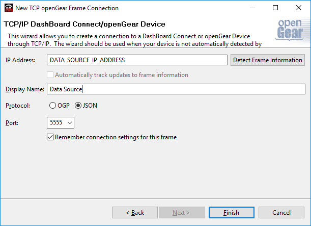

    The virtual device is created by editing the source and supplying the "jsonport" attribute (set to 5555 in my example)

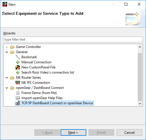

    These are the steps for adding the virtual device to the consumer DashBoard:
    Create/open the consumer custom panel
