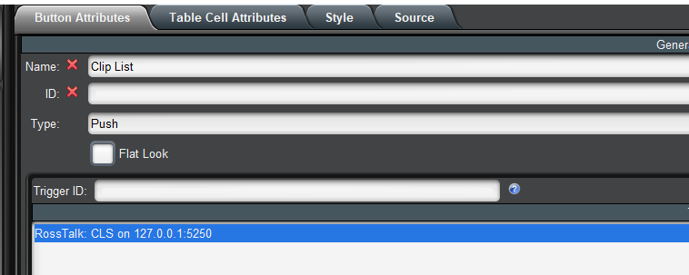

    Hello! I am trying to get an response from CasparCG to show in dashboard somewhere.
    I have gotten dashboard to send commandoes to caspar just fine via custom rosstalk commands like this:

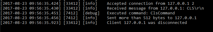

    and i can see that Caspar get the commands and respond to them, either play a clip or answers like this:
    Does anyone know where i can show this result and put it in a nice list in dashboard and use for commandoes further?
