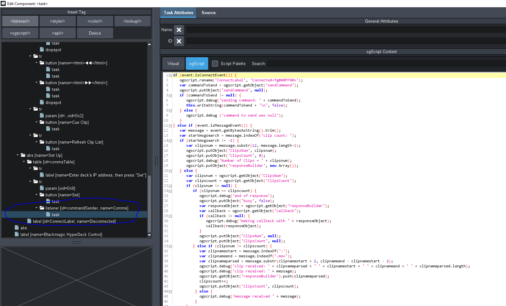

    Same problem here. Can you explain where the "listener task" is to paste this into? I can't find it.
    All the "listener tasks" I look at are currently blank...
  • 6.  RE: BlackMagic control panel dropdown
    Posted 09-18-2020 00:11
    It appears to be at the bottom of the panel:
  • 7.  RE: BlackMagic control panel dropdown
