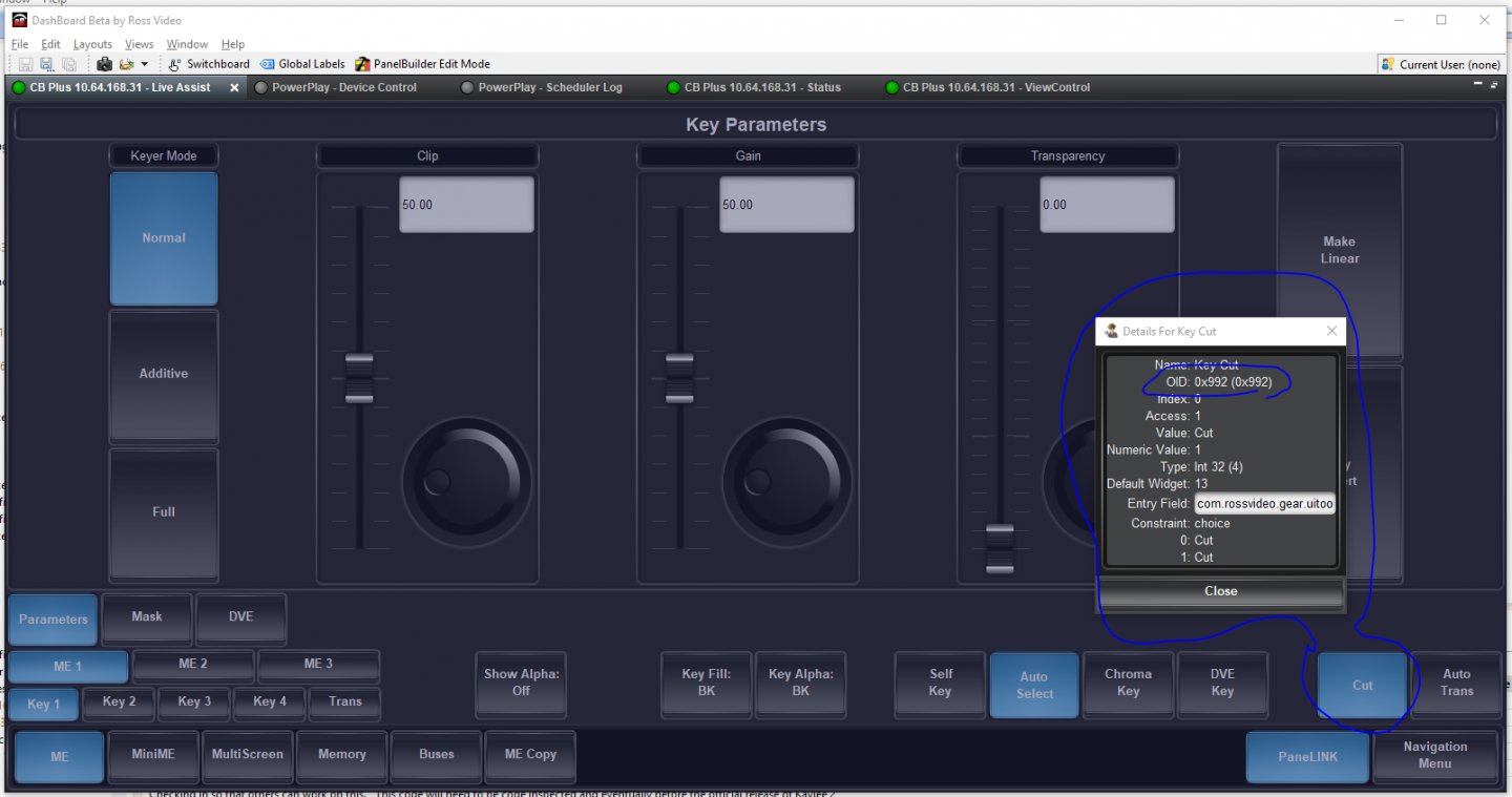

    You can figure out what OID is being used for different UI elements by going into Panel Inspector Mode. You do this by clicking Ctrl-I in a panel. Then you can double click on some UI elements and it will tell you the OID being used for that element. For example, the "Cut" button of ME1" - "Key 1" is backed by 0x992.
    ME1 - Key 2, is backed by 0x996.
    ME1 - Key 3, is backed by 0x99A
    etc.
