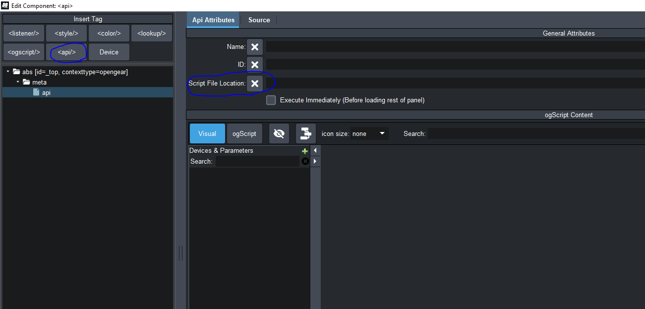

    You can create an API tag in DashBoard and point it to the outside ogScript file.
