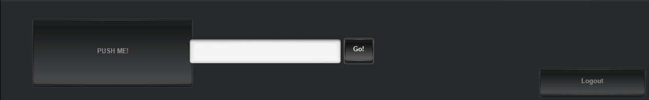

    I was curious if there was a way to have a certain panel on the Ultritouch grid protected by a password - this particular panel would be used to reboot production servers, and we don't want anyone accidentally doing so. Can it be done?
    To clarify, I don't mean the unit itself. I just want a password-protected panel on the grid itself, while the rest remains unlocked.

    There is not presently any password protection built into PanelBuilder for using a CustomPanel. One common approach employed by panel developers is to create a semi-transparent overlay as the top layer of their panel and put a text field on it - if the user types the correct value into the text field, the overlay is hidden and the panel is usable.
    <abs contexttype="opengear" gridaspect="false" gridheight="203" gridwidth="1304" touch="true" virtualheight="203" virtualwidth="1304">
    <meta>
    <params>
    <param access="1" maxlength="0" name="password" oid="password" type="STRING" value="" widget="password"/>
    </params>
    <ogscript handles="onload">ogscript.toTop('overlay');</ogscript>
    </meta>
    <abs bottom="0" id="overlay" left="0" right="0" style="bg#00000065;" top="0" virtualheight="203" virtualwidth="1304">
    <param expand="true" height="48" left="380" oid="password" top="77" width="303"/>
    <button buttontype="push" height="55" left="688" name="Go!" top="73" width="63">
    <task tasktype="ogscript">if (params.getValue('password', 0) == 'password')
    ogscript.hide('overlay');
    params.setValue('password', 0, '');</task>
    </button>
    <button buttontype="push" height="141" left="62" name="PUSH ME!" top="34" width="326"/>
    <button bottom="7" buttontype="push" height="63" name="Logout" right="7" width="217">
    <task tasktype="ogscript">ogscript.reveal('overlay');</task>
    </button>

    Note: In this case, the password is "password"

    James, thank you for the reply. I've been experimenting with using a conditional check on a text entry field to allow a command to proceed, which seems to be working too. I've made the text entry field very narrow and transparent so the password isn't visible; is there a way to hash out the entry?

    The example code I posted does just this - change the widget hint associated with the text field to "password" and you'll get "*" instead of the typed characters.
