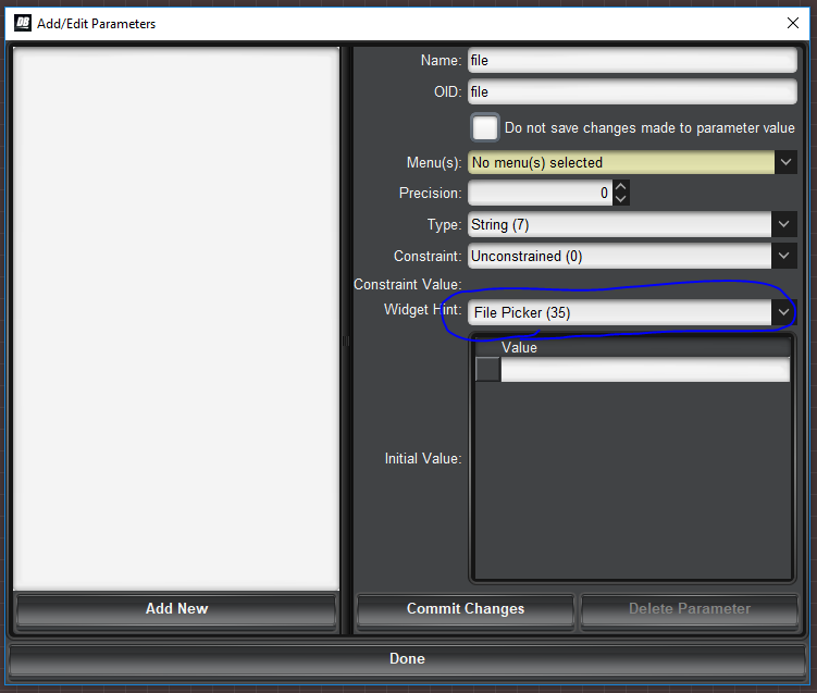

    You can make a parameter that has a widget type of "file picker":
    You can then drop that parameter into your panel and put a task on it so it runs when the file changes.
    Here is a very short example panel that just outputs the file name when the user chooses it.
