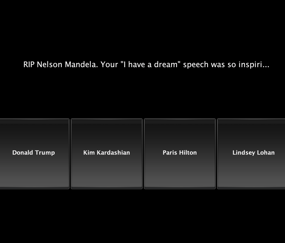

    Is there a way to make a button that changes the background color of a visual parameter like this one? So if I push a button the BG of this box turns green or red.

    For your second question as to how to change the background color of an element, this can be done with the "ogscript.setStyle" function.
    Example below:
    <abs contexttype="opengear" gridsize="20" id="_top">
       <button buttontype="push" height="80" left="100" name="Click me" top="100" width="200">
          <task tasktype="ogscript">ogscript.setStyle('text1', 'bg#FF00FF');</task>
       </button>
       <label height="80" id="text1" left="360" name="Changes this" style="txt-align:center;bg#181818;bdr#7A7A7A;bdr:thick;font:bold;size:Bigger;" top="100" width="300"/>
