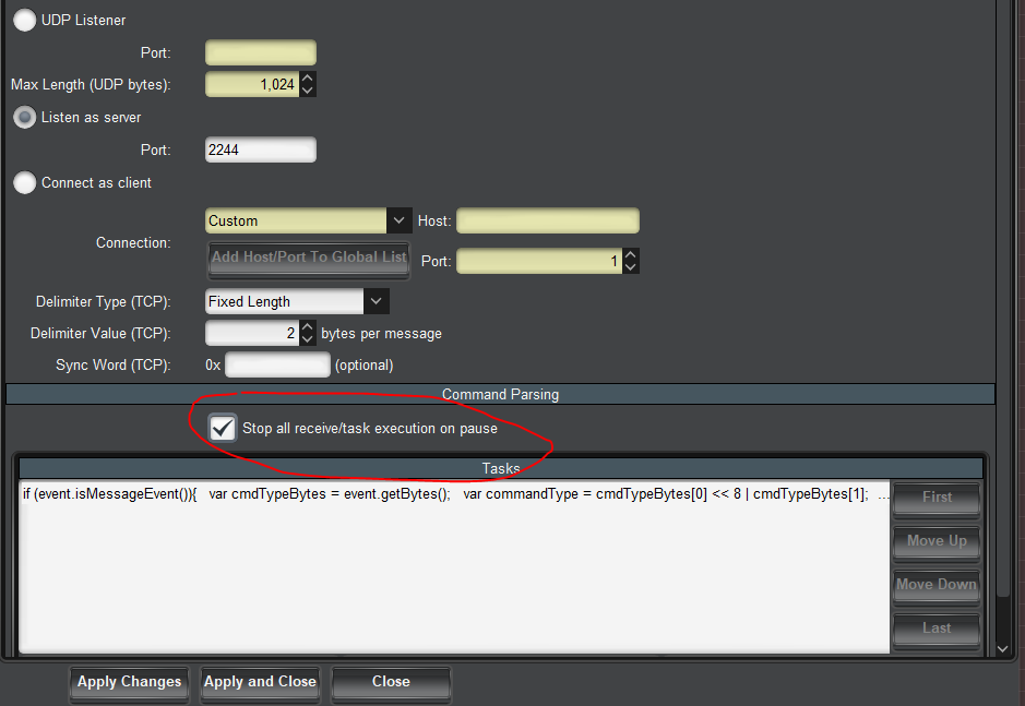

    Once you get the first byte of your message, you can continue reading from the listener's input stream if you pass "this.getInputStream()" into ogscript.createMessageParser:
    if (event.isMessageEvent())
    var cmdTypeBytes = event.getBytes();
    var commandType = cmdTypeBytes[0] << 8 | cmdTypeBytes[1];
    var messageParser = ogscript.createMessageParser(this.getInputStream());
    var length = messageParser.readShort();
    var string = messageParser.readString(length);
    ogscript.rename('output', 'TYPE: ' + commandType + ' MESSAGE: ' + string);
    If you do this, just make sure you check the "Stop all receive/task execution on pause" checkbox to keep more tasks from getting queued/called with information from inside of your listener's connection.
