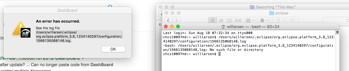

    After downloading Dashboard software on a iMac (El Cap 10.11.6), I am getting the following error preventing launch that references an eclipse log file:
       An error has occurred.
       See the log file /Users/admin/.eclipse/org.eclipse.platform_3.8_1234140297/configuration/1566136115524.log
    I then tried to find the log file in Finder and Terminal with zero success. See the attached screengrabs of those actions. What could be preventing startup? Thanks!

    Hi Justin.
    Does the folder /Users/[USERNAME]/.eclipse/org.eclipse.platform_3.8_1234140297 exist? Does it have any *.log files in it?
    When DashBoard is unable to launch on Mac OSX it is most frequently an inability for the application to write data to /Library/Application Support/openGear/DashBoard
    You may want to verify that you have write permissions inside of that folder with your account - we typically assign ownership to root and read/write permissions to the 'staff' group. You'll also want to verify that there is a ".metadata" folder inside of there (or that you can create one). Note that since it starts with a dot, this will be hidden in your command prompt/finder unless you are using ls -la to list all files.
    Hope this helps
