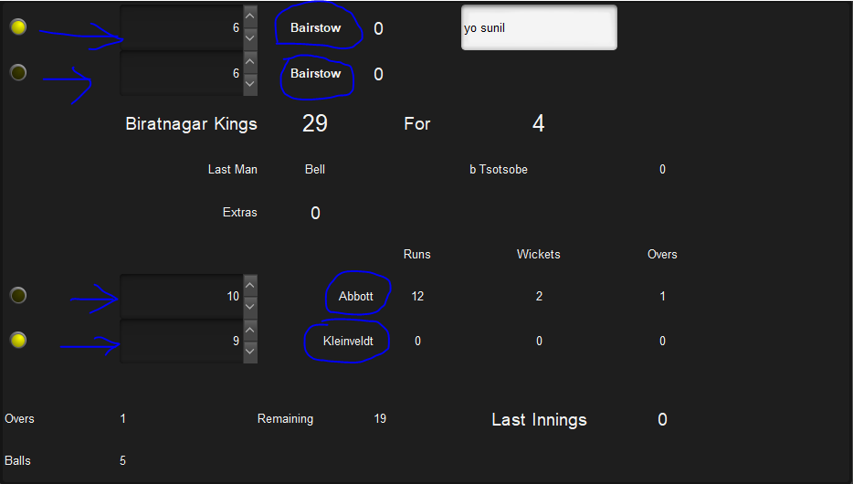

    Hello Expert , iam not familier with scripting.  i got free cricket apps  (in dashboard )  from ross xpression support . The name of batsman are changing according to number in spinner. Those BatsmanName are all label which is not showing in dataliq in ross xpression. Now how can i get this batsman name in datalinq so i can place it in graphics.  please can somebody help me i have attach image also .. thank you .

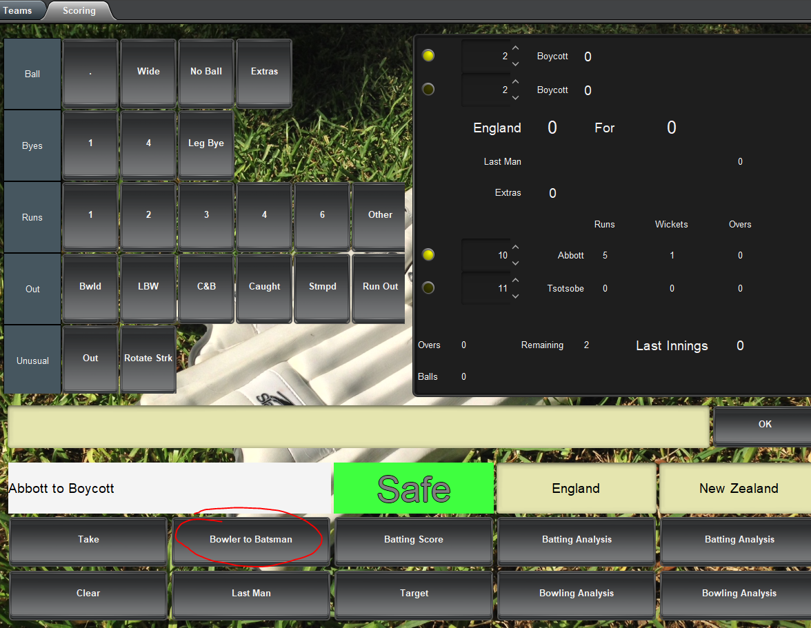

    This panel is not designed to directly DataLinq the names on that part of the panel. Instead, selecting the buttons below will provide useful messages that are sent to DataLinq. Specifically, the "Bowlser to Batsman" button will put the names into a DataLinq parameter.
    The names and IDs are also sent to DataLinq as arrays - you could use scripting on the XPression side if you wanted to do things like present player statistics or lists of names.  Another option would be to create new parameters to hold the bowler and batsman names and attach a task on the spinner to update the parameter value instead of the label - just do a search in the code for "OddBatsmanName" and "EvenBatsmanName" to see where the value are being looked-up and set.
    Ultimately, this Cricket app is just an example of the type of thing DashBoard can do - you are free to take it in whatever direction you choose.
