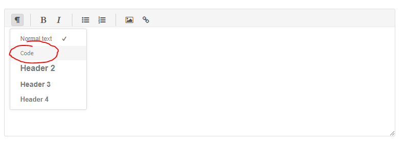

    I have been an irritation folks with my posting of code in the body of a post. What is the proper method of posting code with the scroll bars etc, here in this community?

    There is a drop down option to select "code" to have it format with scroll bars. It still removes leading spaces (for now) but is a little better for proper code viewing.

    Posted 08-09-2019 18:56
    Thank you sir.

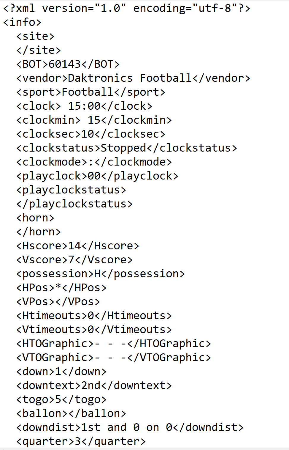

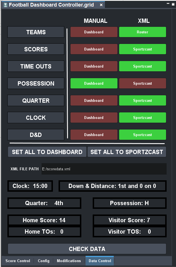

    I was actually able to make Whit's code work with some modifications - so everything is good, though I'd still be happy to learn if there is a more efficient way to address this these days. Below is my Dashboard panel - the lower portion between the "XML File Path" param and the "Check Data" button is what I am extracting from the XML file that Sportzcast's ScoreBot is writing to.
    Here is script that is running on the "Check Data" button:
    Finally, here is the XML format:
