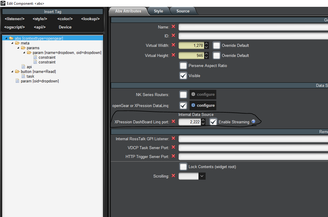

    If that's what you want, I've attached a panel that reads a CSV (also attached) and creates a combobox constraint based on the first row of the CSV file.
    You can turn on streaming on the DashBoard panel so that this information is available as a datasource to XP as well. There are also other ways to stream that information from DashBoard to XP.

    There are 2 ways of doing this depending on whether or not you are using the XPression plug-in for DashBoard.
    If you are using the XPression plug-in, you should be able to set your image path as a published field on the XPression side and, when combo box selection is changed, set the value of the published field for your Take Item in XPression to the new image path.
    Otherwise, you can use DataLinq to feed your current combo box selection to XPression and execute a script on the XPression side to update to the appropriate image. If you are going this route, I would strongly-recommend posting in the XPression forum for further assistance.

    hi, bit confuse about xpression plug-in. is this MOS plugin or what. i can do it on xpresssion using dalinq and combo box. if i change name image will change automaticall. but i want to do it through dashboard. do i need scripting or is there any other way through dashboard. and how can i read specific column of csv file in dashboard. i tried to read specif column but i cnat get it it alwasy read first column only in dashboard. i mean of csv file .
