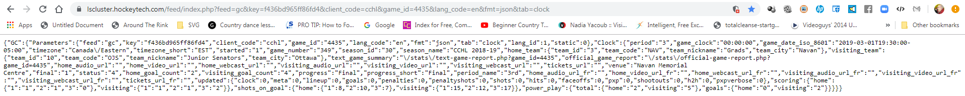

    2. The raw JSON data looks like this:

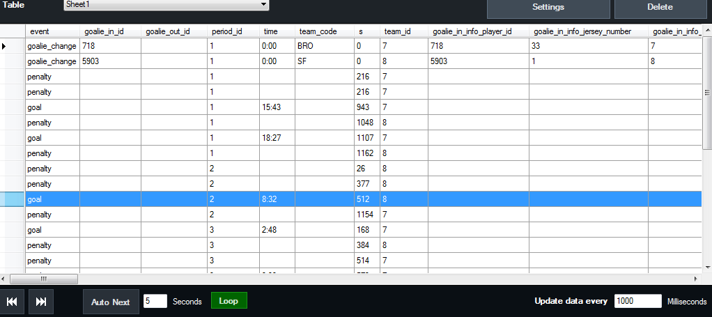

    3. When imported into the dataSource manager it looks like this:

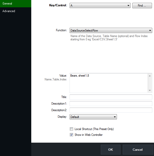

    4.The "shortcut/command" in vMix looks like this:
    Using Dashboard to contol vMix the ogscript looks like this:
    This then populates the graphic from the data in that row

    Well... I was kinda stuck on the same part you are... And I went a bit deeper down the rabbit hole...
    If I understand you correctly, you're using the JSON DataLinq Source in DataLinq, and you want DashBoard to decide what row is being used to get the information, correct?
    I could not do this back in version 6 of Xpression when I started. I think I might know a way to do this now in version 9, but have yet to be able to test that out. However, as version 9 was recently released, I had to find a way around this to begin with. So...
    Instead of using the JSON DataLinq Source in DataLinq, I built myself the same table as you have in dataSource Manager with the info and all in DashBoard, then built myself a parser in DashBoard using more than one asyncExec in order to keep updating and getting these infos in the background. The parser then updates a table in DashBoard with information. I can grab this info, put the values needed into fields that are then sent to Xpression through the DashBoard datalinq.
