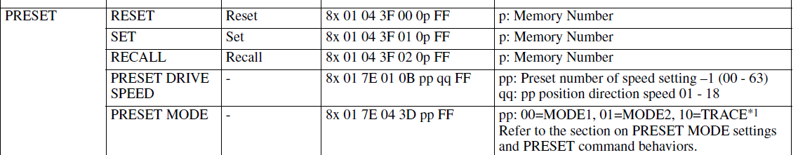

    I have a SONY SRG-300 setup on our network which we control via its network interface.
    We have a bunch of presets made, and was wondering if it at all possible to control via a dashboard script.
  • 2.  RE: SONY PTZ control via dashboard
    Posted 01-16-2020 14:18
    Hi Tom,
    Thanks for your query, Here is what I found for you!.
    Yes, we support Sony Camera Panels. We usually sell these Camera Panels and support if a customer wants any further support from the Camera Panels.

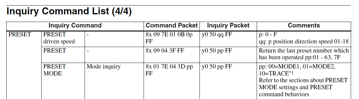

    On other hand, If you want to try on your own, you can use the simple VISCA protocols to control the camera presets.
    You can find full list of protocols for each control under below link.
    https://www.sony.net/Products/CameraSystem/CA/BRC_X1000_BRC_H800/Technical_Document/C456100121.pdf
    Note: Sony BRC and Sony SG-300 share almost same protocols.
